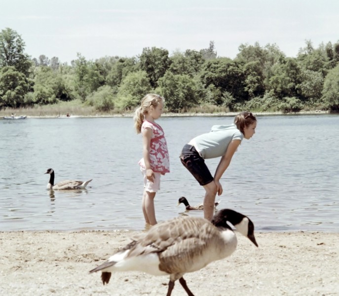

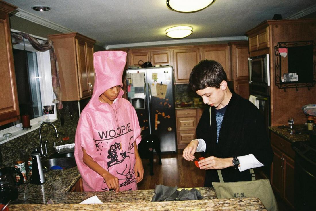

I received as a gift an SLR 35mm Canon EOS Rebel T2 a few years back, and I have never been satisfied with the quality of the pictures. It seems that my Pentax point-and-shoot that I got in 1991 took better pictures, especially in low lighting situations. I am not a "photographer", just someone who loves to take pictures and wants to always capture the moment, so I don't need the best quality but want my pictures to look good.
My question is what could be the reasons/fixes for my pictures always looking dark, lacking clarity (not necessarily blurry), and not having vibrant colors. I use the auto mode on the camera, a Quantaray 28-90mm lense, the built-in flash, and have used 800, 400, and 200 film (usually Fuji). I don't think it's the camera because it's practically new still since I haven't use it much, but I think it is either the lens or most likely the flash not being sufficient enough in the low-level lighting? I had no problem with my Pentax P&S in low-level lighting, so I was expecting the SLR to provide at least the same, if not better, results. Thanks.

examples
couple of examples from the 200 film I used on Halloween. I can probably find other examples from previous film shot that would be 400 ISO film. I just feel like my pictures don't look vibrant, kind of dingy (these examples are actually not as bad as some of the others, but I don't want to show the full faces of my nephews on the net).

My guess is that the issue is mostly the direct flash on the camera. The lens (Quantaray?) may be a contributing factor also.
I would try to find a cheap flash that you can bounce off the ceiling. I doubt the problem is the film, I use the Fuji 800s (superia & pro) all the time and they're great films.

The lens is nothing special, but I'd say the light is a bigger factor in these kinds of shots. Unfortunately, you can't do much with a built in flash. With a separate shoe mount flash, you can usually swivel the head and point it toward the ceiling, so it isn't so harsh.
You've also got some other issues going on, like holding the camera level. If you've got straight lines at the edge of the frame, try lining up the edge of the frame in the viewfinder with, say, the edge of the ceiling or a cabinet door. Try getting a little closer to your subject, and think about shooting vertical instead of horizontal, when a horizontal shot is going to include a lot of extraneous stuff.

comments on the example photos you posted:
1. There is much grain. This can be caused by a number of things. If the film is no exposed properly, this can cause excessive grain. But other causes of this are damaged film from heat or X-rays, expired film, bad development, or just a grainy film.
2. Quality of light. Shots with on-camera flash have a certain look to them that is generally disappointing. Do you have any examples in daylight?
3. Composition. Its a snapshot, what did you expect?
