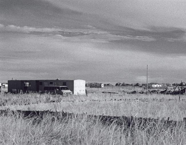

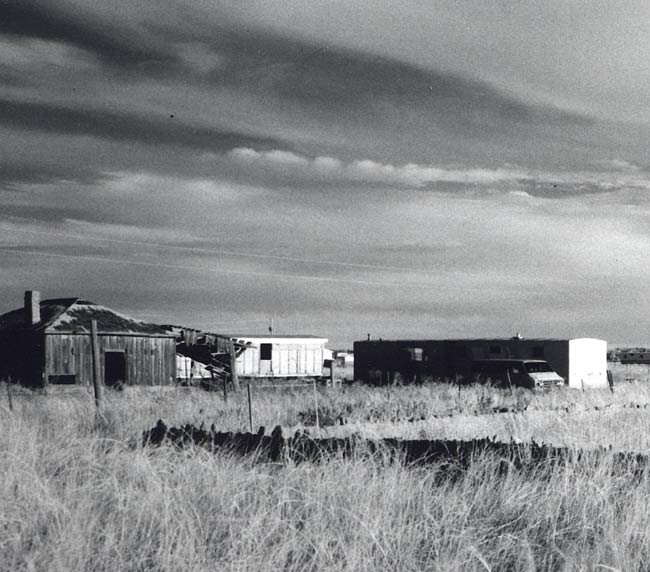

    I am wondering if I have the wrong film/developer/agitation combo here or is this what others experience with Classic Pan 400 film. I developed 4X5 sheets in a Joboi, using a manual contstant agitation floating in a water bath. The density was a bit high, I think I need to reduce my times a little, but I love the contrast and thought that the image came out beautifully, except for way more grain than I expect from 4X5 film.
    When I printed this to 11X14, it looked more grainy than what I am used to with TX and 645 fomat negs. That is a ton of grain for 4X5. Is this a bad developer for the film or for constant agitation? Do you also wonder if maybe I was too agressive with the speed at which I spun the drum? Any other ideas?
    I am attaching a couple of scans. One is most of the image and the other a crop of part of the image to show grain. I have only done unsharp mask, 100% at 1 pixel, to the scan, not other manipulation. Excuse the crap from the scanner bed!
    Thanks!
    Paul.

    Well, on the bright side, the highlights aren't blocked up :smile:. I agree, that grain is way more than I would have expected. I've not tried Classic 400 but, do have some little bit of experience doing TXP in HC-110 with continuous rotation (Jobo tank, lego lift). I use dilution D and have never seen grain like this - not even with 35mm at 8x10.

    This isn't really helpful either except to me but I can only detect grain in the thumbnail on the right. The left one looks totally different in terms of grain - much smoother. To my probably untrained eye there is a real difference between the two thumbnails in terms of grain.

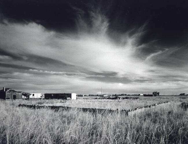

    Well, I seem to have solved the problem. This time I developed in D76 and was very gentle with the agitation. Basically, I agitated about as gently as I could while maintaining constant motion. I am very happy with the results. I am attaching scans of the image that I took today, a still life of a light from our studio, and the one from the original problem negative. They are very different subjects, but I wasn't about to drive an hour to take a test shot, so I just found something. The difference is quite dramatic. I might try HC110 with gentle agitation just to see if it was mostly the difference in agitation or developer, but one of the two changes sure made a world of difference.
    FYI, both of these prints were made today with the same paper to exactly the same magnification. I basically moved my enlarger up as far as it would go and printed an 8X10 crop of the resulting image, so this is a pretty large degree of magnification, equivalent to a print larger than 20X24.
