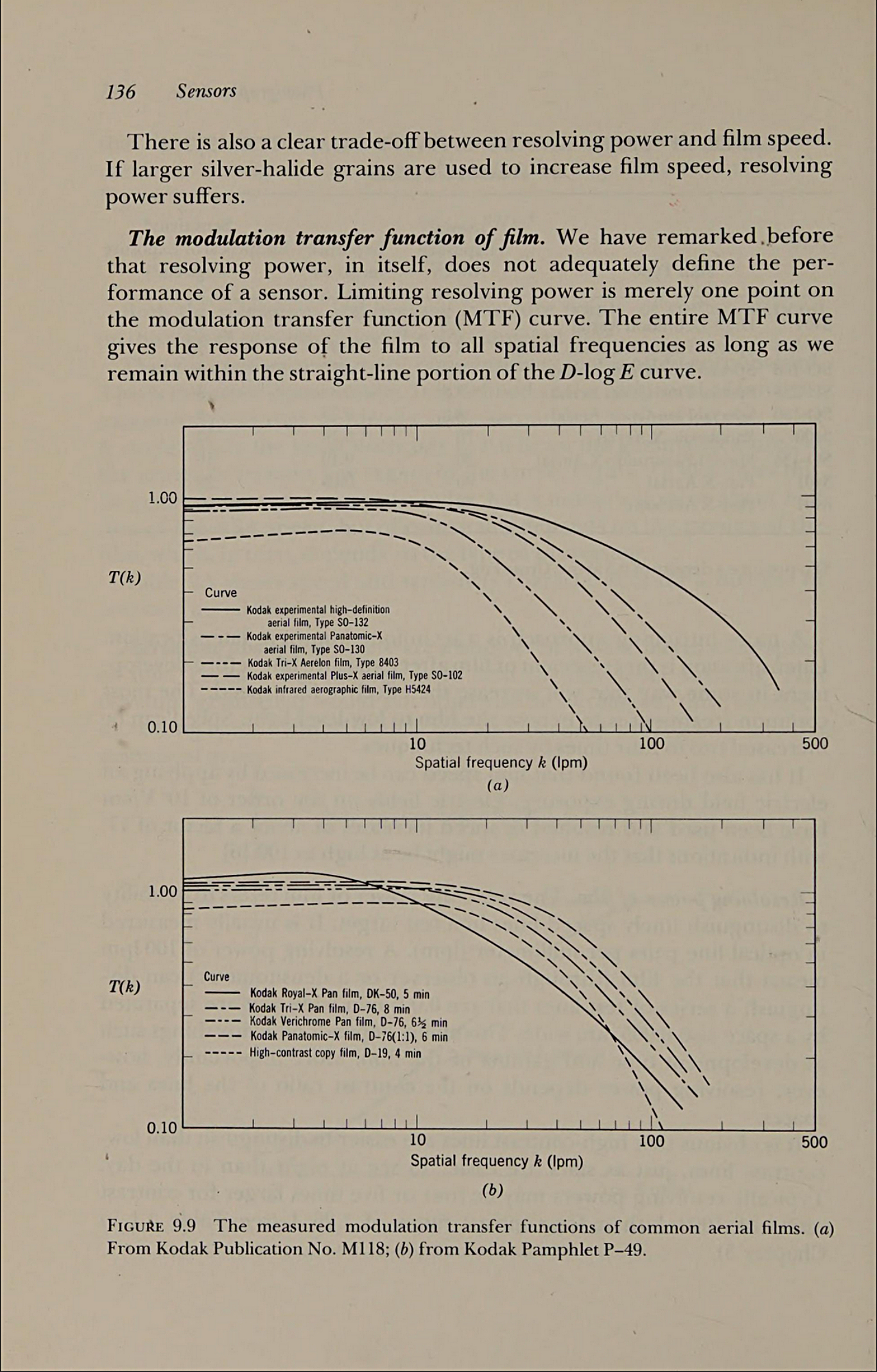

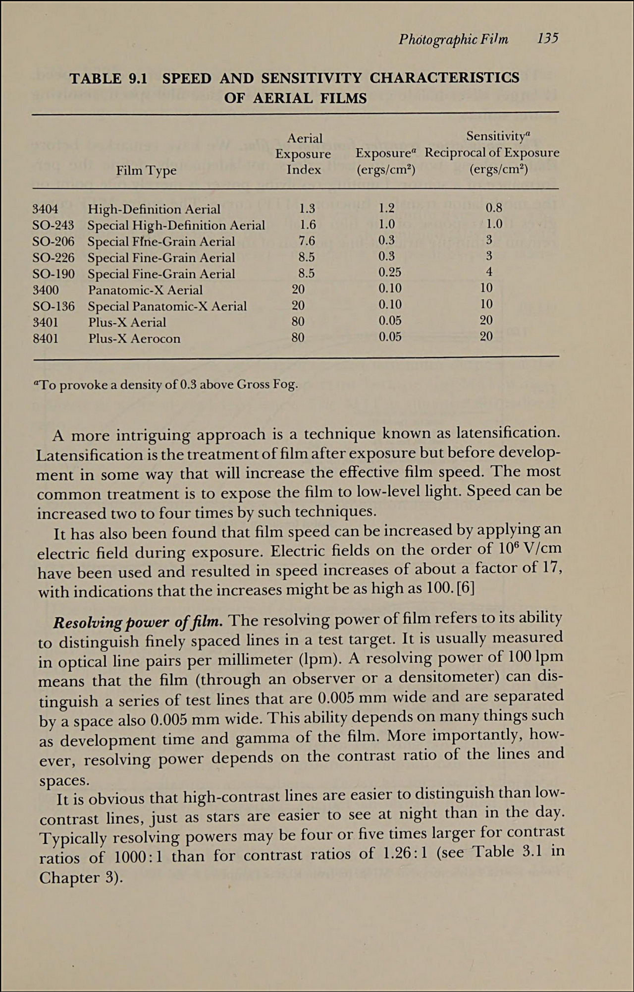

I'm guessing the table at the end of the second page is more of what you've already found, a mere referral?
It's from "Optical and photographic reconnaissance systems" by Niels Jensen Publication date 1968
Ref to Kodak Publication P-49 p135.jpg Ref to Kodak Publication P-49 p136.jpg

@Molli Nice one thank you, after work I know on which site I'll go - Internet Archive is still a bit choppy since the hackers attacks last month, but we can login again
