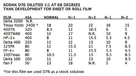

ToddB
Jul 10, 2012
1,134
Shooter
Found it.. I realize that this bench mark, but used this in the past and worked really well.

Bill Burk
Feb 9, 2010
7,898
Shooter
as others already said,this cannot possibly work.Conduct your own test.:wink:
ToddB,
I don't trust calculators or charts from anybody else, though they can provide a starting point, I really value having a spot-check of the development contrast... Even if it's only a two-point test.
It would help to know who came up with the chart and if there is a book or publication explaining how the times were derived.
Odd that the chart agrees fairly well with my N times for 400 TMax - even though my times are for 4x5 tray development... which isn't the same times I use for roll film in small tank.
Rafal Lukawiecki
Feb 23, 2006
794
Wicklow, Ireland
Shooter
Bill, this chart has been copied from an earlier edition of Chris Johnson's "The Practical Zone System". It is almost identical to a table from the 4th edition, bar one entry for 400TX. All the remaining text is identical. He did testing with a friend, hence the references to "we" in the text. Also, the order of entries in the table was based on their estimation of which film behaved the "best" with a given developer, top to bottom for best to worst combinations, for which each table was made (D76 1+1 in this case). The quoted table has the same order as the one in my copy of his book.

Bill Burk
Feb 9, 2010
7,898
Shooter
Thanks Rafal Lukawiecki, I appreciate the attribution. It helps reinforce what I was seeing, that the chart is high-quality information that provides a good checkpoint to corroborate personal tests with or a starting point for those who don't want to do testing. I might add this book to my reference library so I can see the work that was behind the numbers.
It also caught my attention that the chart doesn't agree with your N-times, but I assume different developer...

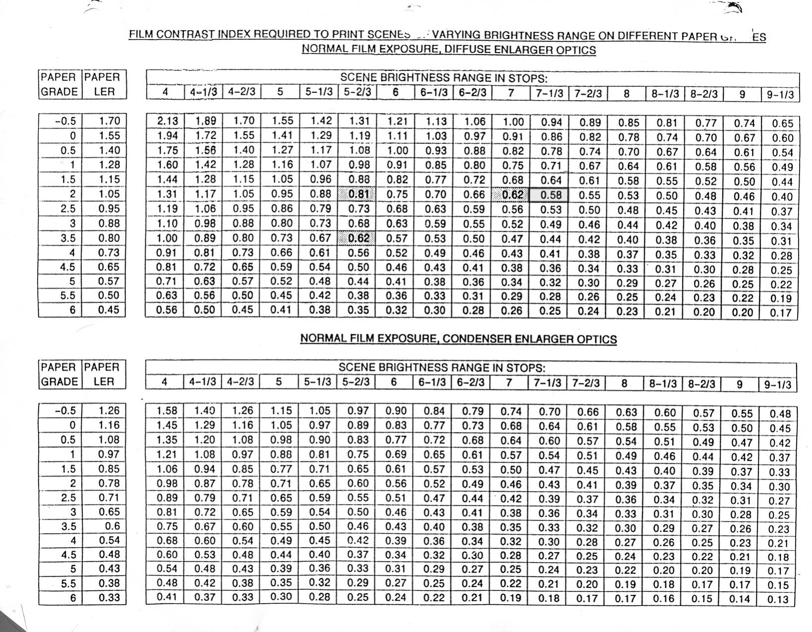

RalphLambrecht
Sep 19, 2003
12,877
K,Germany
Shooter
here is some more reading on the subject:
enjoy.
:confused:

Bill Burk
Feb 9, 2010
7,898
Shooter
Ralph,
That is the exact Kodak chart I use. *Note the right hand column is mislabeled. It's 10 stops.
