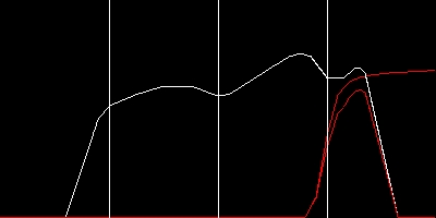

Next I created a ChartThrob Step wedge with the base color, printed and scanned. Here is the result:
The first three steps are pure white and then it goes to Dmax at around 50%. This is reflected in the curve created by ChartThrob:
In addition ChartThrob tells me that while this is a valid curve, I might want to consider reducing my exposure to make more optimal use of the paper/emulsion.
So, here are my questions:
  1. How does my HSL array look? I notice that other ones posted seem to have a more gradual transtion from light to dark - mine seems more abrupt.
  2. Given than my first ChartThrob test shows me achieving Dmax at 50% should I consider reducing the contrast of the emulsion. Wouldn't that be better that using a curve that maps my 256 inputs to only about 128 outputs? Does that matter?
  3. I notice quite a bit of dithering on my step wedge. Is that indicative of what large areas of midtone will look like on my final print? I had the impression that diginegs (done well) don't show these artifacts. However, I do see them on other peoples test charts - just not on their final prints. Is that just because the final prints are less magnfied and the dithering is still visible?
Any advice on where to go from here would be very welcome.

1. The HSL looks good. Lots of areas of potential for density. Different than an Epson but that's fine. I would just keep that curve moving toward the corner though. Don't know why ChartThrob abruptly zigs it into the wall like that.
2. What you could do if posterisation (read: lack on tonality) is a concern is lessen your reliance on contrast agents until your negative colour achieves dMax density equivalent to the colour of say RGB 127,0,0. This is deep enough that the CcMmY are still the only heads producing the blocking colour but not so dark that black ink in taking over in the driver and giving you a drop in resolution. In essence you're matching the capabilities of your printer and inks to your emulsion. Compromising, giving a little on both ends. See what your first print looks like though. At least you'll have a bench mark to show improvement.
3. You'll know once you see the print if artifacts are an issue. All printers are not created equal. You're right they're exaggerated on step wedges a lot of the time because people are printing small to save on materials. They might not be as noticable in the final print.
I'm interested to see your results. That's the image you're going to print? Nice!
~m
p.s. judging by your ChartThrob test print RGB 255,17,17 will "nail" your blocking colour to the corner.
~m
