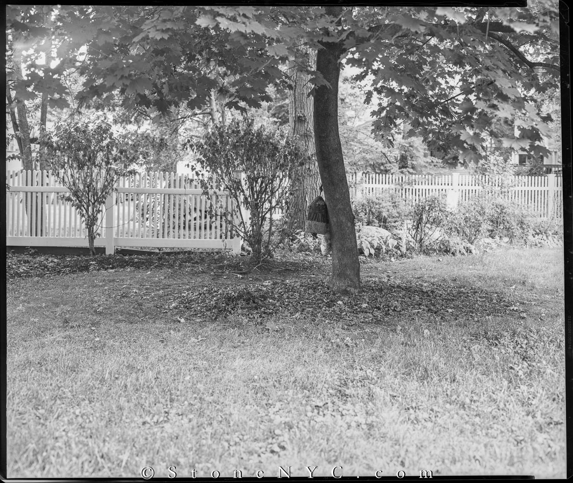

Sure, but most who are shooting large are contact printing not scanning, 8x10 or 4x5 Wouod make more sense for someone drum scanning. "In my book" anyway.
Sadly, my test images for the wide open shot with my home built 14x17 was plagued with light leak, I hadn't seated the holder properly and it wasn't flush against the back BUT you can still see that there's no actual falloff of light at the corners. The corners are all out of focus so it doesn't tell anything for sharpness. When the new 14x17 that's a lot more refined is complete, I'll make new images, but for now this crappy light leaked image will have to do.
Again, total fail as a test image (and not supposed to be very artistic) but sufficient to see that there's little/no discernible fall off at the edges. Look between the upper right and bottom left corners. Neither are dark.
And the second image at f/22 which I didn't totally have light leak with...
Suffice to say the 450 M is perfectly fine on a 14x17 size wide open and as many have noted, 20x24 at f/22
