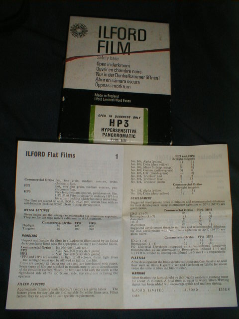

Full, unopened box of HP3 sheet film. It's interesting... the film feels like it's wrapped in a sort of thick matt-coated foil (had to poke around it immediately in a darkbag! :tongue: )
From the leaflet I am guessing this is c.1968 only because of the "C 68/B" at the bottom of the info sheet and I read up and found out this film was made between 1965-1969 (with the ilford paddlewheel logo on it).
Probably going to try out a sheet for enlarged negatives since I don't have a 4x5 camera yet. Just going to try the usual times I use for fomapan100 sheetfilm under the assumption that it was ASA 400 back in 1968 and it might have lost 2 stops by now.
It's neat seeing that ID-11, Bromophen, Microphen and PQ Universal were all around back then.

HP3 (as wounded film) was introduced in 1941 rated at 125ASA. Sheet film followed in 1943. In the early fifties it was rerated (speed increase?) as 200AS, in 1960 rerated as 400ASA due to the speed margin becoming obsolete. It was finally replaced by the HP4 in 1969, which started being offered alongside in some formats as early as 1965 (1960?).
