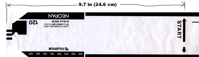

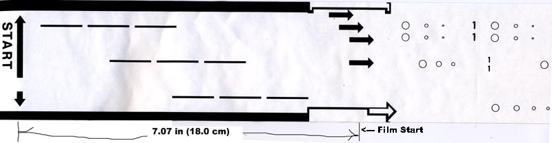

Just happen to have a backing paper left from the last roll ...
hot off the <shhh> sc@nner </shhh>

Wow, this is a great forum. The scans DWThomas posted show that I did over-run the start arrow, so this roll is going to miss some frames. Many thanks for all the fast reponses. As you can tell, I do not shoot a great deal of 120 film, but I am planning to start some fairly intensive use of this RB for black and white work.
