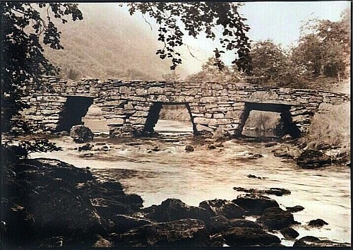

I have used MACO Lith RC-F and some other MACO papers, several different Forte papers, several from Kentmere, just about everything from Bergger, as well as Varycon/EFKE PE RC.
Most of them have given warm highlishts and midtones, none of them have come out of the fix as pure black and white.
Here's a sample - on Fortezo Museum, MACO developer:
