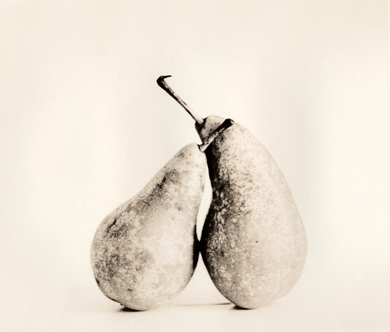

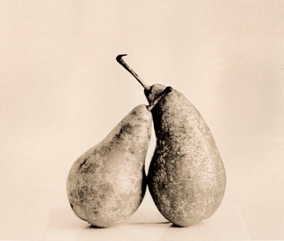

You will get fine lith result already at first print in Easylith, but it takes approx three prints to get into full bloom. Please find pictures attached of examples in Easylith 1:15, room temperature.
Go grab a package boy! :wink:
Good luck!

FYI, picture no 3 is exposed for 90s at f5.6 (a half stop less exposure than #1). Developed for 9:30 minutes in 1:15 Easylith @18C (65F).

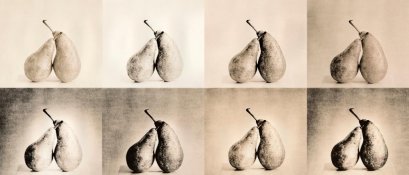

Attached you´ll find the whole series of this pear stilleben neg I used in a lith printig class. For educational purpose, different parameters were changed successively (exposure, snatch, temperature, dilution) to show different appearence.
No 7, for instance, is the equivalent to #1 but 1:30 dilution @34C (94F), instead of 1:15 @19C. It is somewhat "gloria" burned in but developed for the same time, i.e 8:35 minutes in this case. As can be viewed, the appearence is different and the lith grains are really accentuated, due to developer maturity, but still rather smooth. Let me know if you´d like a bigger picture to review the grains.

About photogrpehs attached by you - 7th very nice as for me. Could you show it on bigger size?
