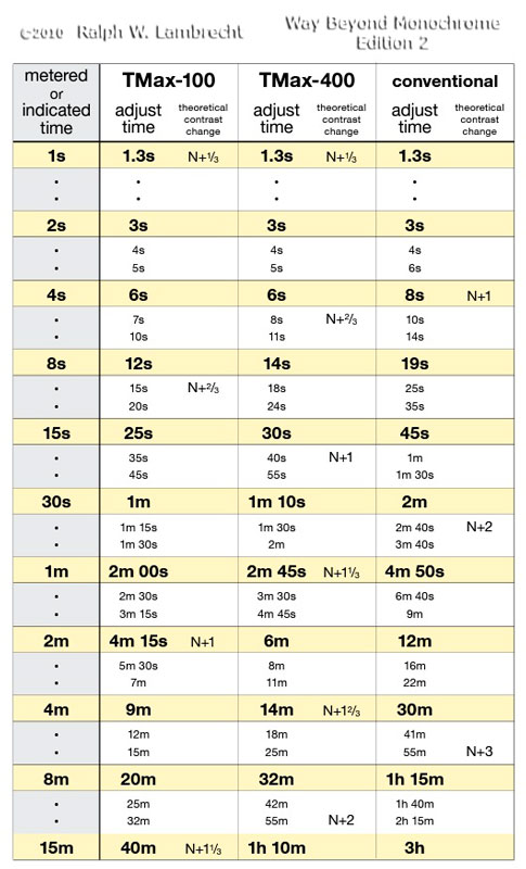

    Close enough, but don't forget the reciprocity failure with long exposure times!

    Here's an earlier post with reciprocity corrected times that include HP5+. The chart is based on data from Howard Bond's extensive testing in an article in Phototechniques magazine, 2003. Metered times are in seconds, adjusted times are in mm:ss format. Data went to 240 seconds. Adjustment from metered times longer than that are extrapolated from the data.
    http://www.apug.org/forums/attachment.php?attachmentid=13810&d=1238435346
    Lee

    Holga 120WPC pinhole camera results: Before going out I was careful to load Ilford HP5+ and used gaffers tape along the back cover seams and frame counter window to keep light leakage at a minimum, and used a Minolta IVF incident light meter to take readings. I took six 6x12 exposures: #1-set meter at iso 100 @ f64 meter, indicated 1-second, shot @ 1-second. #2-meter set as before indicated 1-second, shot @ 1.3 second (adjusting for reciprocity using table provided by Ralph Lambrecht). #3-set meter at iso 400 @ f22 and used Pinhole Designer software table, indicated 20th second, shot at 4-seconds. #4,5,6,-set meter iso to 100 using f64, indicated 1.5-seconds, shot at 2-seconds. Timing of the exposures was done in the primitive one-one-thousand manner. I processed the film using Ilford Ilfotec DDX developer 1+4 dilution at 68F for 9-minutes. All the exposures were usable, but,the best exposure was #2, using the reciprocity table. Thanks Ralph Lambrecht.

    I'm glad to hear that it worked for you. Many thanks for the feedback!
