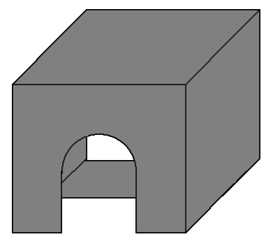

Jim Jones
Jan 16, 2006
3,740
Chillicothe MO
Jim McD said:
Ansel Adams used his hat
And I've used my hand. I have several photos with unfortunate proof of that. Lens hoods can be improvised out of scrap mat board. An inverted U-shaped cutout on the back of the hood permits the back of the hood to be slipped behind the back of some shutters. A cutout on the bottom provides access to the shutter. Of course the interior should be painted black. With a little ingenuity the design can be modified to be collapsable.
