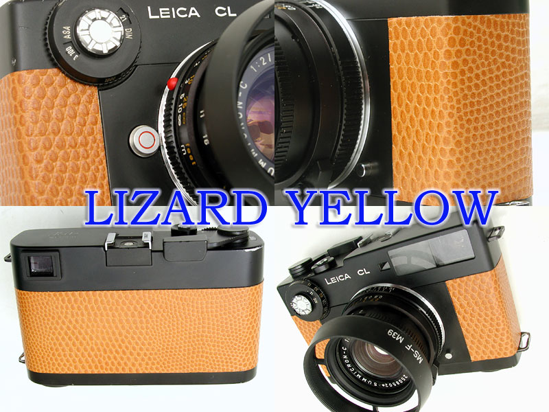

Got one!
After losing numerous auctions in ebay I finally won one. You can find the auction from here
I allmost bought a m2 in one stage, but I'm glad I didn'd because I would have any money left to buy lenses. :rolleyes: But I have to get one of those M's in someday because I realy fell in love with the m2 when I tried it in one local shop.
I ended up getting the cl with the orginal 40mm, so no more trouble at choosing a lens. I think it was the best solution.
I also ordered a new skin for it from the aki asahi. It is going to look so good!
