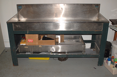

Leedal Stainless Steel Sinks
Hi Gary,
My uncle was one of the founders of Leedal back in the 1950's. I do have a 7Ft. sink on a steel farme stand of his that I was used for many years (20+) and it served me very well and is still in great condition. If you are still looking for a great sink, I would be willing to sell it. I'm in Chicago if you are nearby please let me know if you are interested. My email address is david_weinstein@att.net
