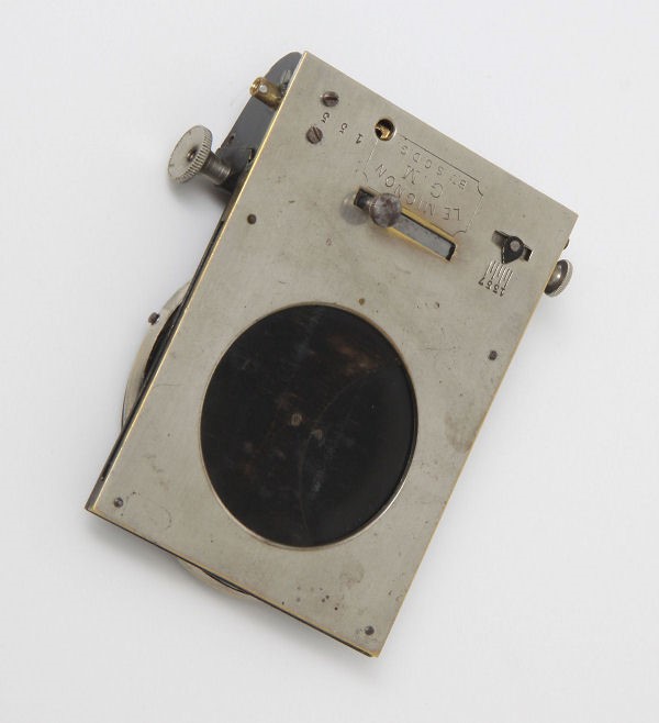

    Many thanks to Andres who gave me this shutter when we met up in August (2017),, it had some issues as there was no release mechanism. It's designed to front mount on a brass lens. Note the back cover has been removed to show the mechanism below.

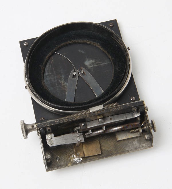

    [​IMG]
    It could be cocked and released with a screw driver through the hole on the front, or through the side. The original pneumatic release was missing.

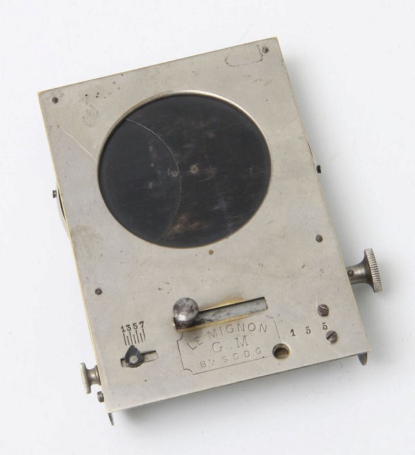

    [​IMG]
    Using brass tube which I threaded to take a cable release I made a simple plunger to trigger the shutter mechanism.

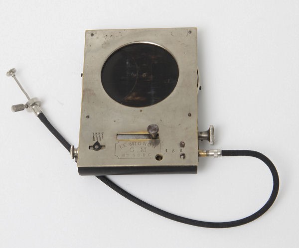

    [​IMG]

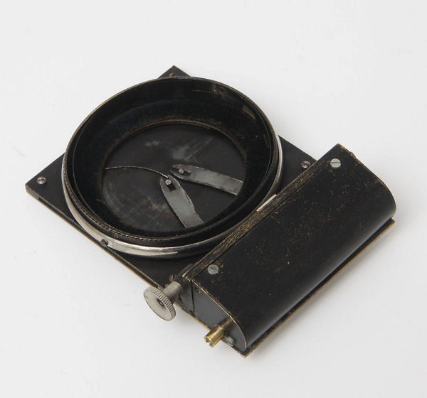

    The new tube is bottom left and the cover is replaced..

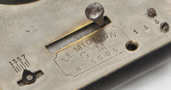

    The shutter is now fully functional, I need to test the true speeds as there's some adjustment of the shutter speeds, see the 1-7 scale on the bottom left.
