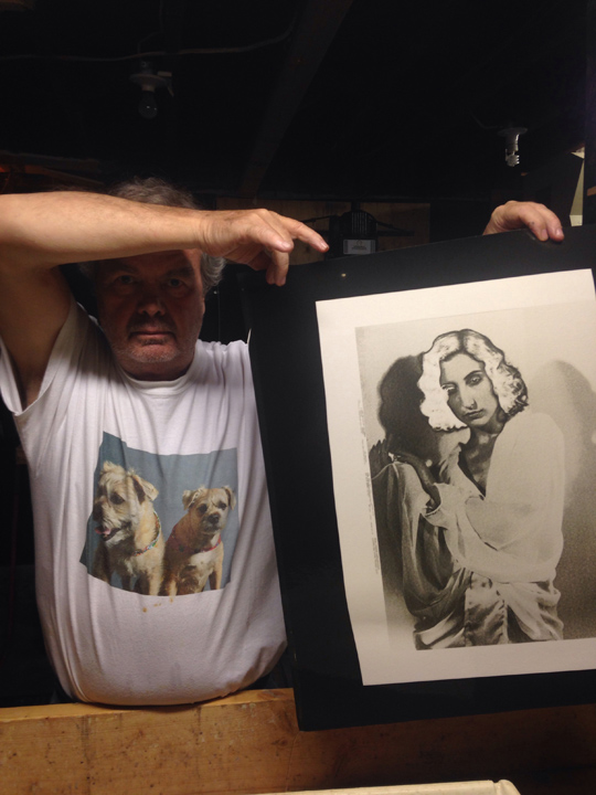

    Brendan Meadows.jpg Image courtesy of Brendan Meadows
    So I comprimised and processed 1/2 time in HC110 and 1/2 time in Solaral - the flash was given once the film was completely immersed in the second dev.
    The print you see is a Contact of the solarized silver negative from phase back capture. The print is a lith print on Art 300.
    I really think this will be a great series... Brendan now has to figure out how to light the original scene so that he can control the solarization a bit before I hit the flash.
    What is cool about this process is that since the film is Ortho 25 I can use a safelight and with some extensive testing Brendan and I can work this out to a predictable workflow for him.
    This work is Slated for Capture 2018 Vancover and Contact 2018 Toronto so we have all the winter to work out the bugs.
