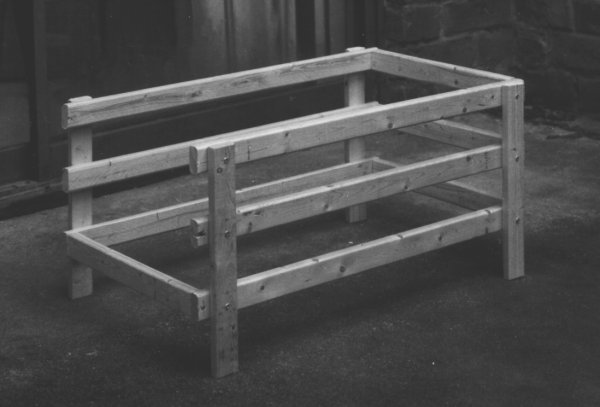

Stack them up. I have a critical lack of space in my darkroom (no sink, and it's actually a closet, not even a "room"), so I built a rack out of 1x2s which holds my dev, stop, and fix trays; it's about 12 inches tall, and has the footprint of about one and a half trays (11x14s, in my case). I think it cost me a whole $5 in parts, and 2 or 3 hours to build.

Hi Jerold, my tray rack is quite stable even when the trays are full of solution, though it's not 20x24. I don't imagine a bigger rack would be too bad, though, because the trays are supported along the entire length of the long dimension. On mine, I've left the top two tiers open at the front, so I have full access to the trays; I was concerned that it would weaken the rack, but it's still quite solid. The joints are all glued and screwed (heh). Check the pics I've (hopefully) attached.

I think my biggest concern with a rack like this would be the potential of having chemistry from one of the higher trays splash or slosh (technical term) into one of the lower trays.
That concern might be met if you had two rows, and two columns, with developer, under water bath, and beside that, first fix, under second fix. obviously, you would need the extra room, plus a space for final water soak/wash and HCA.

I had a crude version of a tray ladder in my first darkroom - I found an old wire shelf from a refrigerator, and a friend welded some legs on it. That allowed me to put the developer and stop on top, and the fix and rinse/holding tray on the bottom.
I think the key is to load the ladder for use from top to bottom. You certainly don't want to get any stop in your developer, but you can't avoid the converse. So put the developer above the stop, the fix below that, and if its a four level design, the rinse/holding tray on the bottom.
