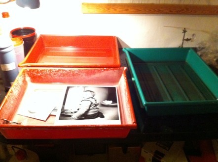

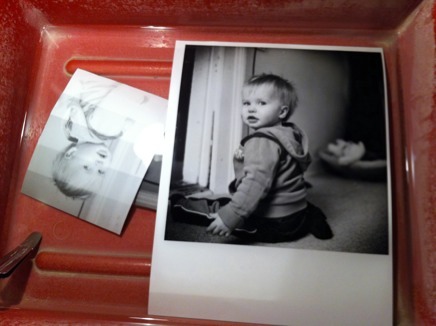

And it Was fantastic. :smile:

As far as I can see, those negatives printed nicely! What are your feelings about the lack of contrast you were talking about?
Flyfishdk
Mar 1, 2011
32
Denmark
it's the scanner and that process there. I was really in doubt.... I'm a pj and think I can expose a picture.. thats why I thought it was strange. But now I'm very happy :smile: Thanks for all your inputs :wink:
