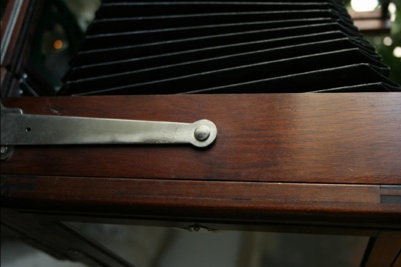

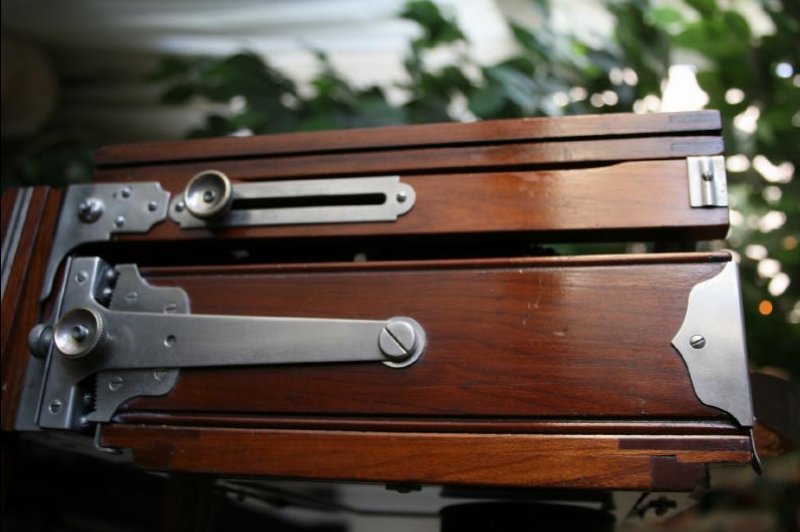

A while back I finished restoring a Korona 5x7. Turned out to be a rather simple job and looks great. Now I have 2 Korona 8x10's that I was planning on giving the same treatment until I found that the pivot for the back tilt appears to be a rivet instead of a screw as in the 5x7. Image043.jpg
If anyone can offer any suggestions (other than removing to bellows, drilling out the rivet and replacing it with something else) I'd apreciate it.

I went to http://www.mcmaster.com/ and found something even better than the binding post. They have a low head shoulder screw that appears to be the same thing I have in my 5x7. That along with a tee nut is all I need. Thanks for the lead!
Btw, is there a way to date a Korona with the serial #? I went to Field Cameras of the U.S. and found a photo of one I have which appears to be a Variation #2. The other one, the one with all the movements is not listed there. If anyone has any info it would be appreciated.
Thanks again.
