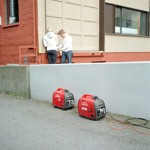

I have a bunch of rolls of the film from 2002, supposedly cold stored. I've shot the first of the rolls at EI 100 as a test. After seeing the results, I've continued shooting it at that speed. Hare are a few examples with different colors. Here is a shot from the first roll:
http://www.flickr.com/photos/cannelbrae/5206172378/

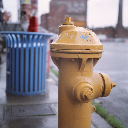

My first roll had a slight red cast to the film base. I adjusted for it while scanning the second roll - off topic here, but I want to be sure I'm not misrepresenting the film. Here is a shot from the second roll:
http://www.flickr.com/photos/cannelbrae/5623438993/
You might want to try bracketing a few shots. I wouldn't be surprised if it near full speed. I agree about how quickly it builds density; my overexposed shots get very bright, very fast. I've been extremely pleased with this film over all though as the detail is excellent and the slight warmth doesn't bother me at all.
