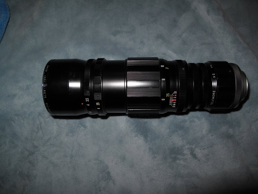

What can I do with this lens?
I have a pristine example of this preset style lens with a Komura 2x adapter, lens hood, and caps with a crappy but original case.
Is there any hope of making this fit a Nikon, canon FD or Eos mount? I cant find any adapters available anywhere and few people seem to know what they are.
Could it possibly work on a a mamiya m645? oops wrong forum...:whistling:
I would like to try and use this on something, but its an odd duck with very few references on the web. I have one very broken Exakta camera and I do not want to buy another 35mm camera just for this.
I am selling off a bunch of stuff as it is to pay for film.
If no one has any ideas, I will probably just put it up for trade and see what I get.

Its time for pictures: should have started that way...
In the above photo, you can see the whole lens with x2 adapter

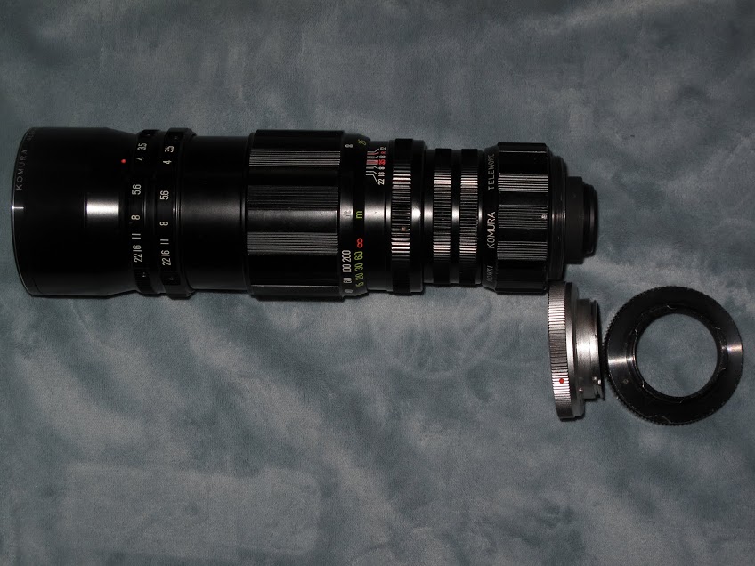

Above: x2 adapter removed. the tube between silver exakta adapter is hollow and can also be removed with yet another unkown thread type, NOT 42mm

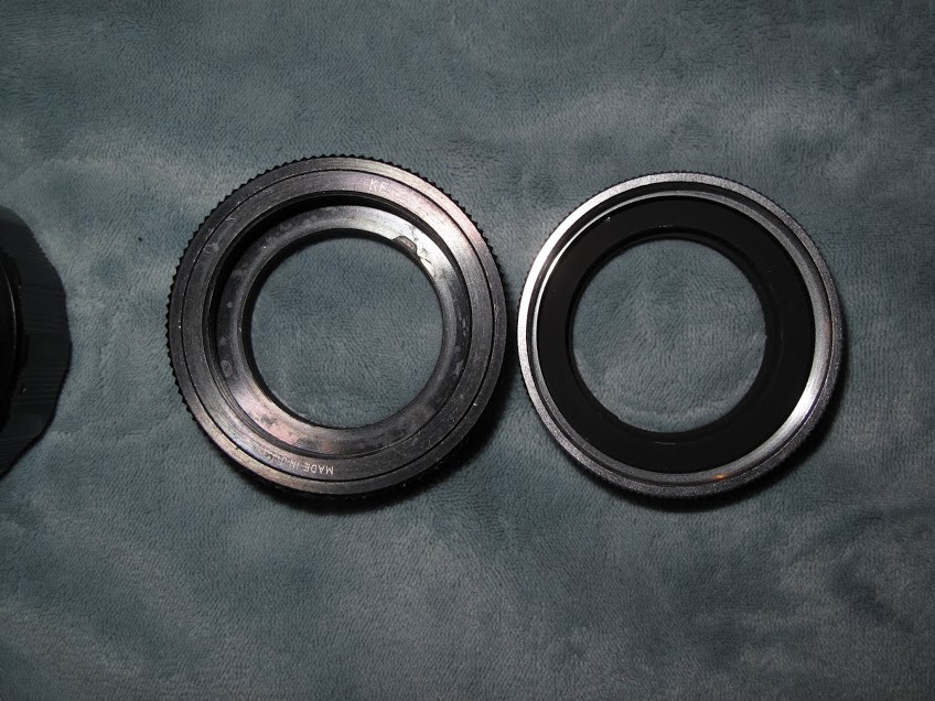

Above left: T mount (42mm diameter @ .75 tpm) adapter from a different lens. Above right: Unidapter 47mm Diameter to exakta mount.

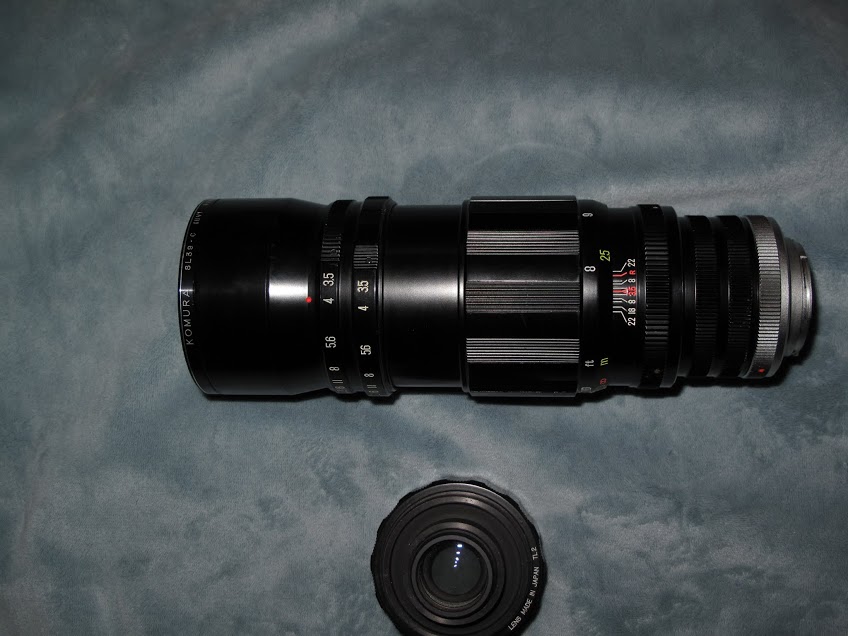

Above: whole lens with adapter removed. Black ring is T mount to exakta just to hold the silver one up.
At 47mm T mounts are just pointless.
I have a lathe, but it does not do metric threads....:-(

You don't need a thread, just remove the Exacta mount portion of the Exacta silver adapter and epoxy/screw the cheap F-mount or EOS mount adapter to it. I've done that with old FD lenses, cheap K-mount lenses, they all work on EOS bodies after that. I used $2-5 M42-EOS adapters and drilled holes in the adapter face to put screws into the body of the lens.
Quite secure and reliable in use. Of course, any lens turns into fully manual diaphragm operation at that point.

Cool idea!
In this case the lens is a preset style and is always fully manual, so no loss there.
