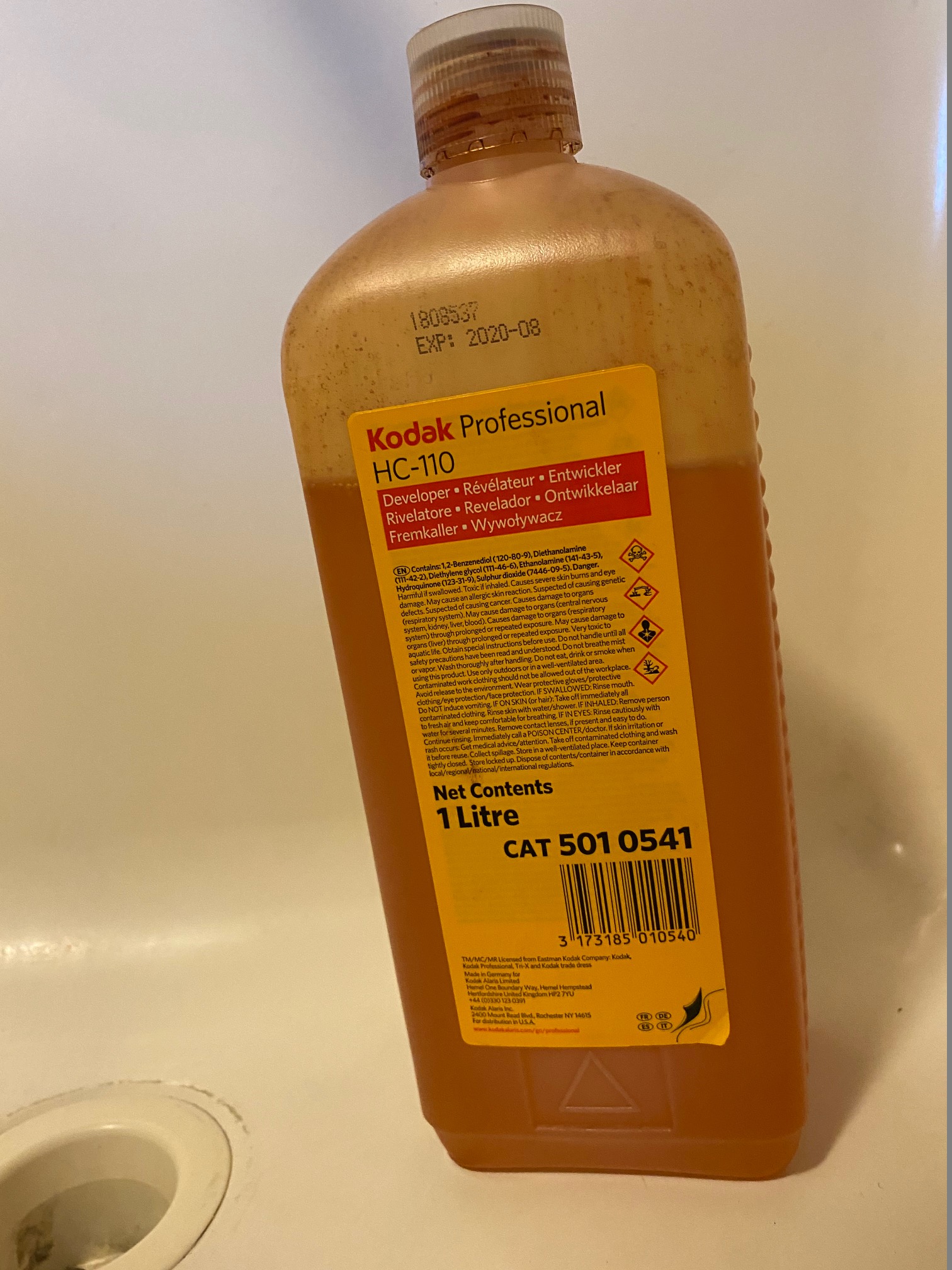

Here is some "old old" (?) stuff I bought in 2019. Made in Germany. Looks like it might be darker in color, but that could be bottle color also (looks similar to when I bought it).
I see "sulfur dioxide" explicitly on my label, but not the Sino Products label above. Different companies may label differently.

The process to make the old, old HC-110 was very specialized and relatively difficult and expensive to do - the creation of a sulfur dioxide adduct to the organic.
The Made in Germany version that markjwyatt shows - the old, old version - was made for Kodak/Kodak Alaris in Germany (most likely by Tetenal).
After Tetenal got into serious financial difficulties, Kodak Alaris attempted to move a lot of its black and white photo chemistry manufacturing to US makers, but they couldn't or wouldn't employ a method that involved creation of a sulfur dioxide adduct to the organic.
Then (July 2020) Kodak Alaris sold the photochemical business to Sino Promise Holdings - just in time for the world to be thrown into disarray by Covid 19.
Now it looks like Sino Promise Holdings is having new HC-110 made, in China, using a process at least similar to the old, old HC-110 in that once again employs a method that involves creation of a sulfur dioxide adduct to the organic.
