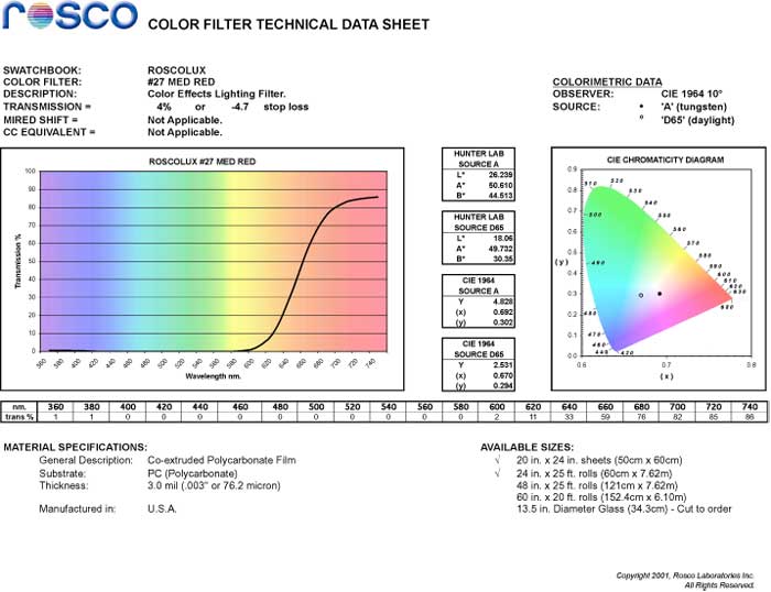

I use the original glass filter that comes with it, plus two layers of red gel. (Rosco #26) Just sandwich the sheets in there and trim to size.
I use a 25 watt equivalent, white LED bulb instead of a 15 watt incandescent. The LED doesn't generate as much heat.
With two layers of gelatin and the original glass, you'll get enough light from the brighter lamp. Just remember to keep the lights far enough away from the work area that you won't affect your papers and stuff.

I've been testing some of the Lee lighting gels - Blood red seems to be a pretty good candidate as a suitable "safe light" filter.... Need to get a full sheet when time allows and do a full on test.
