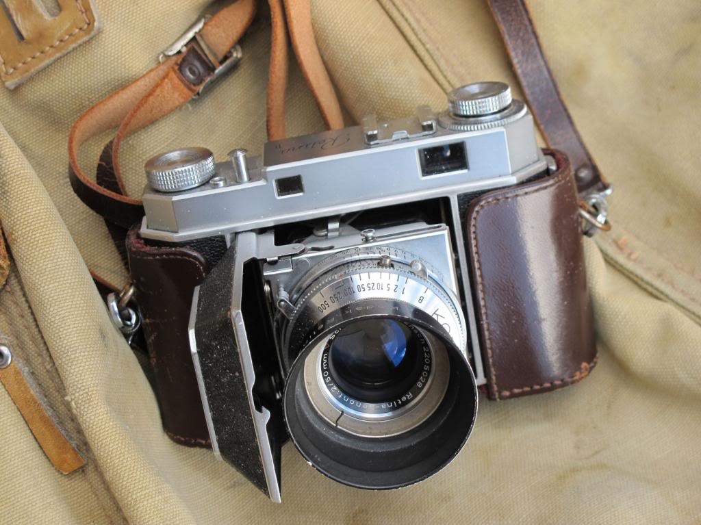

I have recently acquired a Kodak Retina IIa Folder with a Schneider-Kreuznach Xenon 2/50 mm. I have never used one of these before and wondered if anyone familiar with this camera could give me any tips or advice. I must admit I like the design and am looking forward to putting a film through it.

Thanks guys, very useful info.

Thanks again guys for all the advice. My Retina IIa arrived this morning and it is a beautiful little camera in almost pristne condition. It was a nice day and so I loaded it with FP4, set the shutter to 1/100 and aperture to f8 and went for a walk. I could actually fit it in my pocket still in it's case. I only took one picture, but time will tell.
