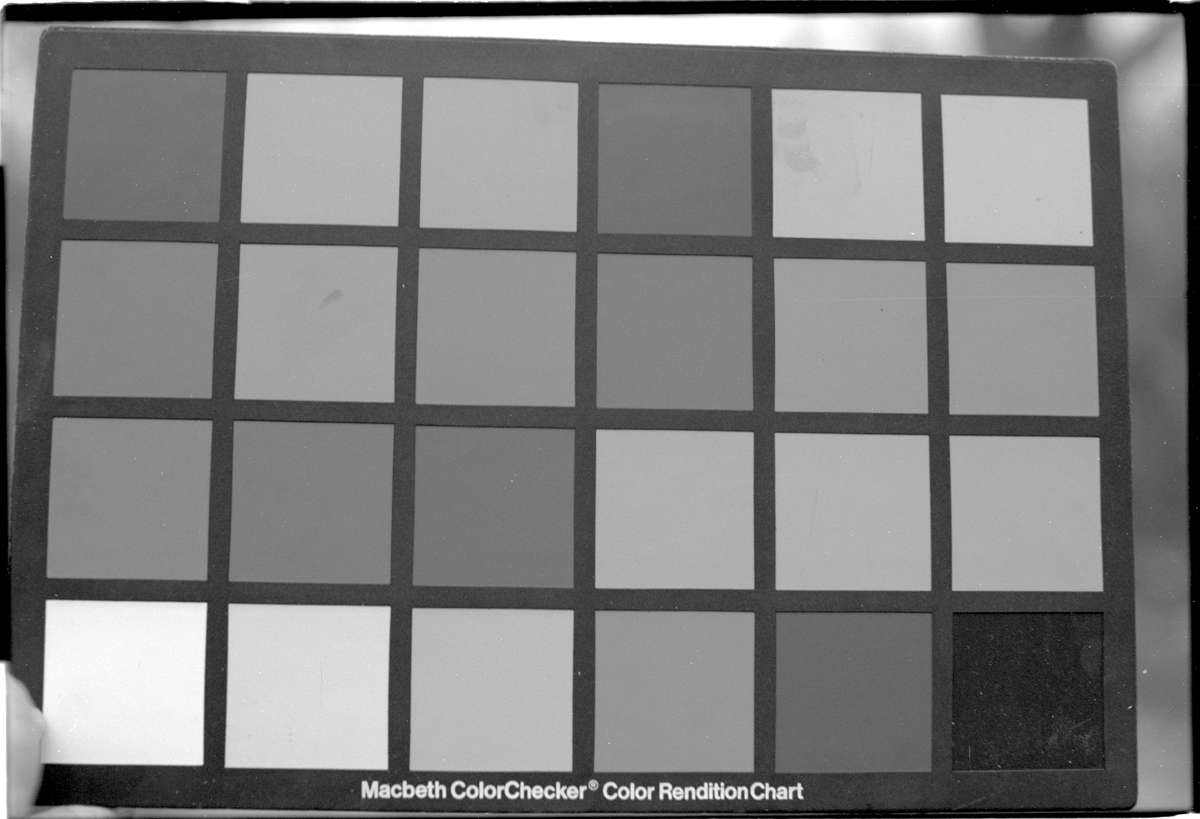

    I rated it at ISO 25 and ended up liking the results when developing it in ID-11 (D-76) 1:1 for 10 minutes. I also tried Rodinal 1:50 at 6:30 but to my eye that was a little grainier and probably needed a little more time to really develop the ISO 25 metered bracket shot. As you can see from the spec sheet, it can be rated and developed in a wide range of choices, which will affect contrast, etc. I was going for the less contrasty end of things.
    Here are some example shots:
