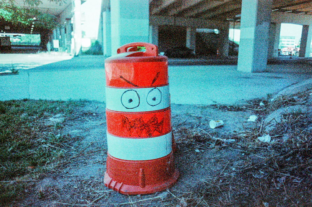

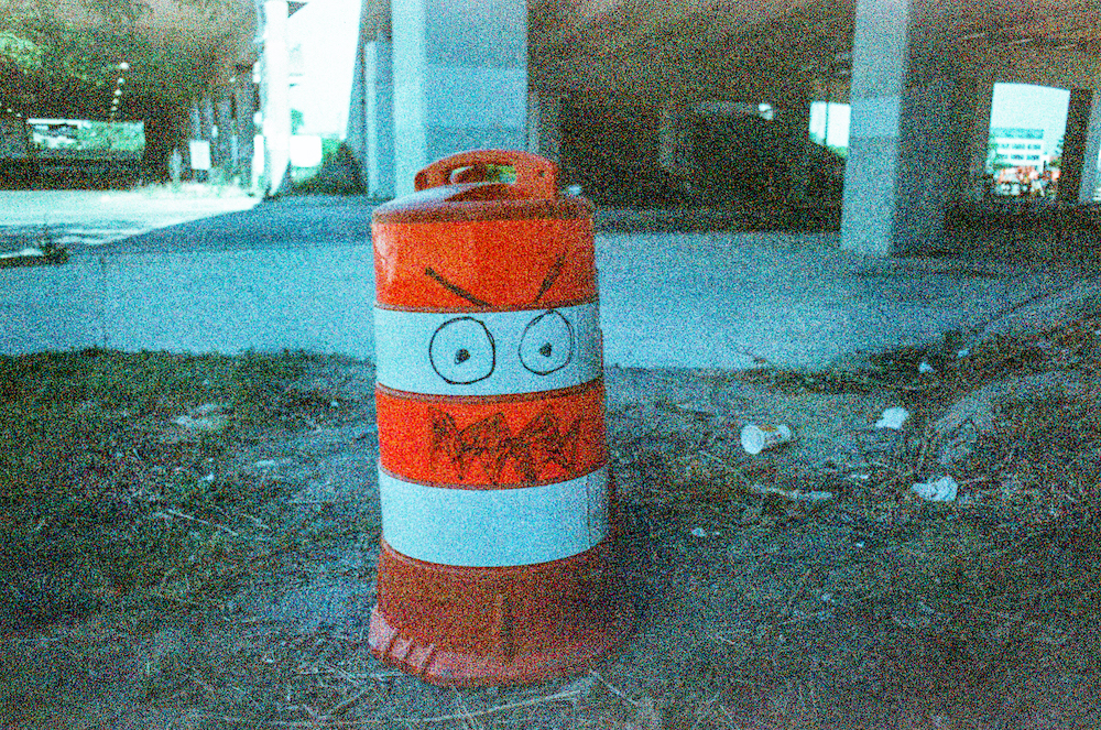

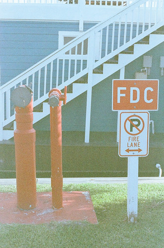

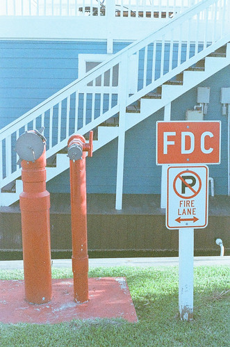

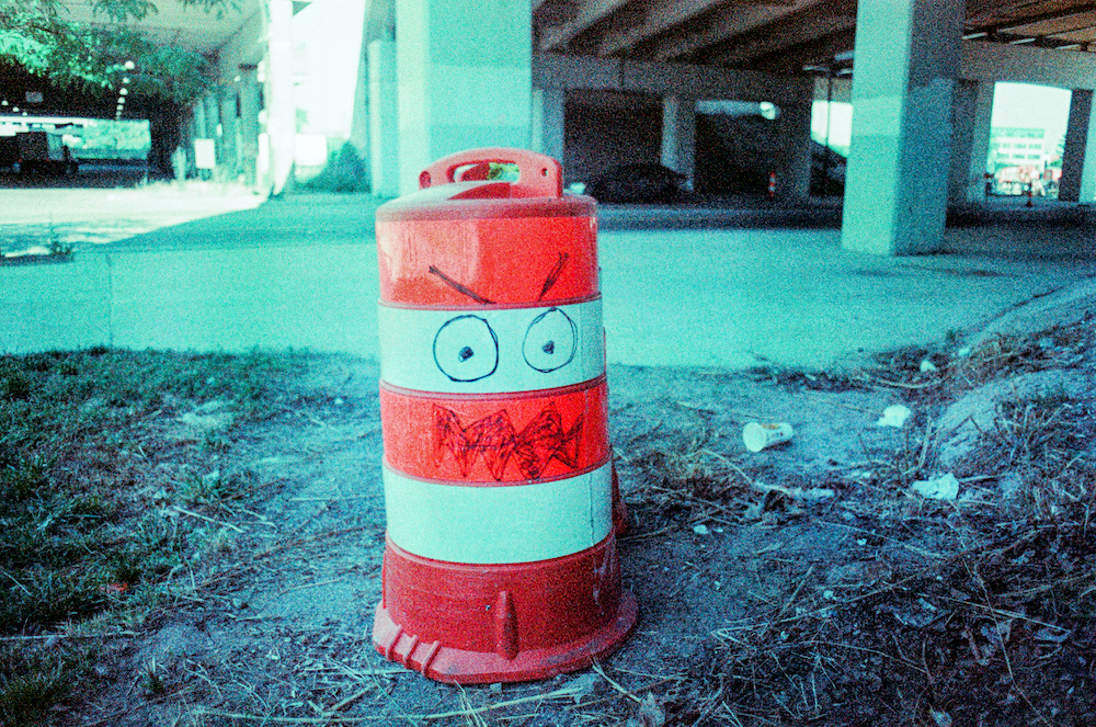

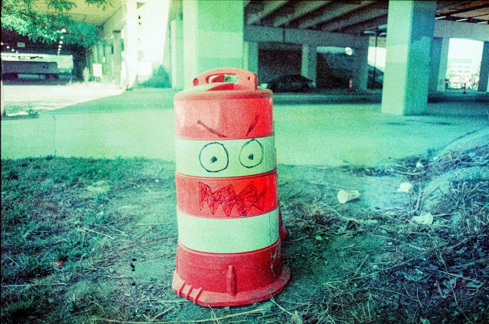

Here is the first roll of test film from the two bricks that I purchased from @summicron1
Under advice from The Darkroom lab, I shot the roll at ISO800. The first frame of every set is shot as metered TTL. The second frame is shot at ISO400 or +2 EV. They were developed as normal, again according to The Darkroom and developed by The Darkroom.
The whole roll is viewable on my Flickr account. https://www.flickr.com/photos/christophercoy/sets/72157714498027828
000107000010 by Christopher Coy, on Flickr
000107000011 by Christopher Coy, on Flickr

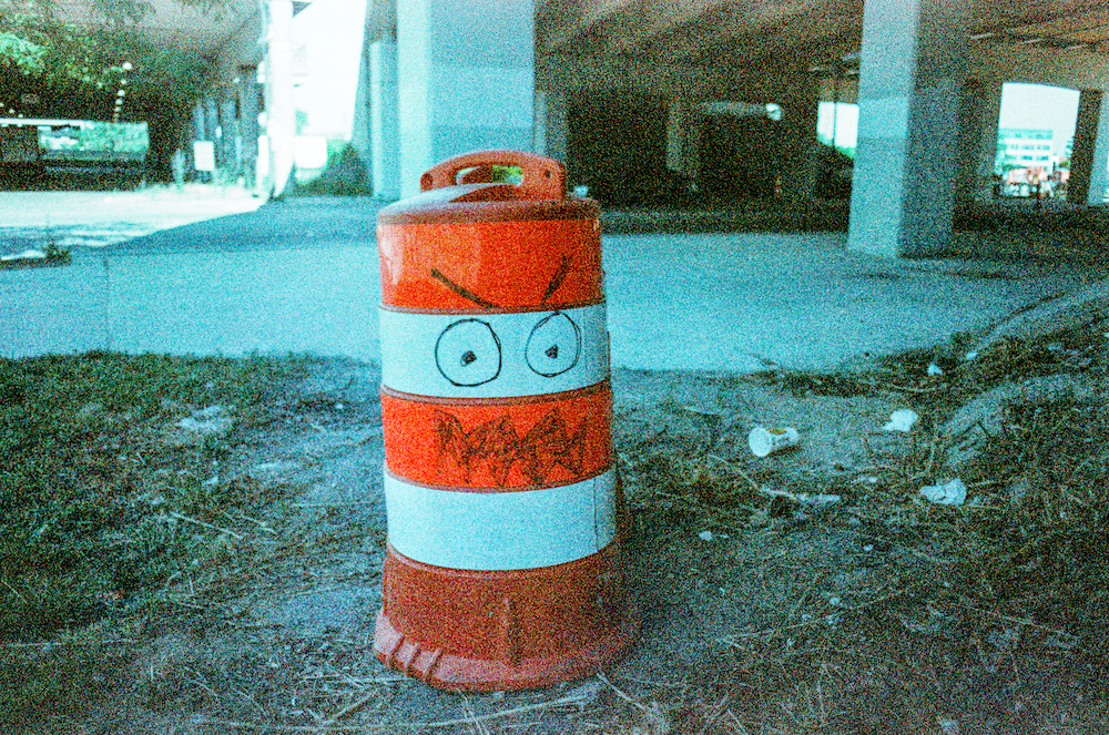

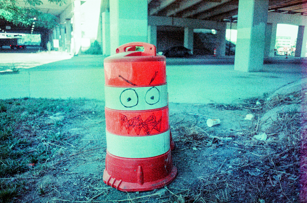

Are these the same type of film? And if so, how did you shoot/develop them?
All from the same roll. the top one was shot at iso 200 (I assumed the film was 30 years expired), and going down I increased my exposure by one stop. I had the film developed normally by my camera store. the results of this test and a the few other rolls I tried showed that GENERALLY, if the standard rule for expired CN film is one stop per decade, high speed film only needs one additional stop. However... Ektar 1000 and Max 800 defied this rule and worked fine with the standard one stop per decade.
So this was Kodak Gold 1600?

I would suggest more exposure, and a strong warming filter to help counteract the heavy cyan cast.
May we see a photo of the negatives themselves?
