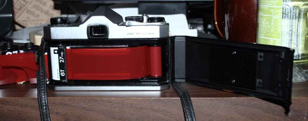

The duplicating film arrived.
Really bizarre stuff.
First of all, it's red. Like, it has a red anti-halation dye. Second, it's unperf. If I use a sacrificial roll of Kodak MAX to donate a couple inches of perf to the start of roll, the old Pentax Spotmatic seems to take it up just fine, though.
It's really slow and very low contrast. I'm trying to develop it in Dektol 1+3 right now, so far I haven't been able to nail down the speed, though. Definitely slower than ISO 1. I'll spin through a couple test rolls today.
Jason
jnovek
Oct 13, 2007
22
In the Spotmatic.
