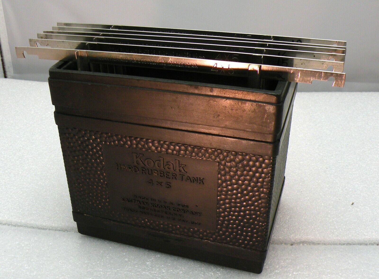

Large tanks refer to hard rubber sheet film tanks. Kodak had hard rubber tanks, 1/2 gallon, 1 gallon and 3 1/2 gallon tanks for sheet film on hangers. Always replenished. If you are using reels/spirals in a daylight tank use the small tank scheme.

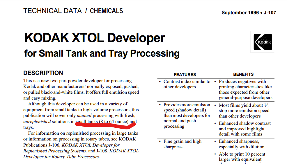

Small tank = 8 - 64 ounces according to J-107 - one of the three datasheets issued in 1996 along with the introduction of X-Tol.
Those would be US fluid ounces.
8 oz. = ~237 ml
64 oz. = ~ 1.9 litres

@RoboRepublic Another detail is agitation interval. For large tanks they suggest agitation at 1' intervals, whereas for small ones it's 30". It's not a matter of volume. And keep in mind that most of the times for large tanks are for seasoned developer in replenished processing (although they do provide times for large tanks and fresh developer).
