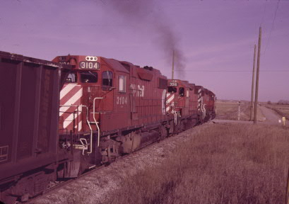

This is some PKM from 2000, although warm stored (20 C) from 2001 to 2005 when I shot and processed it. It had gotten lost in a desk drawer and then I found it and shot it.
PKM-25
Nov 25, 2004
1,980
Enroute
Ouch! That is really bad. Like I said, all my stuff is and has been frozen. The 96 might be the clincher.
