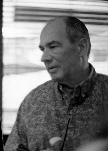

Cut in the dark, it was a shot of two friends talking.
14 minutes in D-76 1:1 is probably just right.

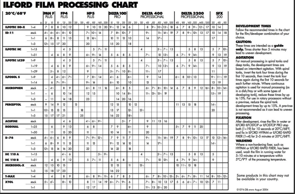

I have just pulled this off the Ilford website, so this should be up to date with times and recommended agitation times the only one I would take issue with is the one for Rodinal and rely upon the times, dilution and method of agitation.
