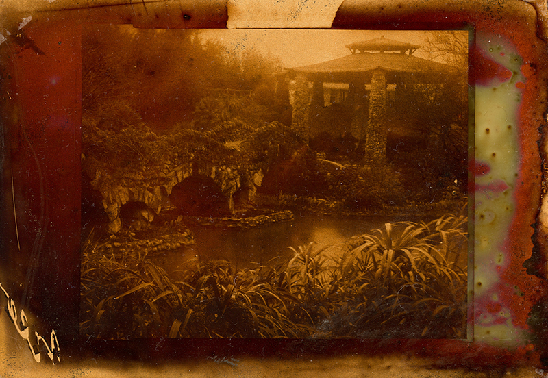

I wanted to share a Kallitype process that I started to use to help improve my original Kallitype, dry-plate, experiment. In the original experiment I used a gelatin subbed plate which I brushed or pooled on a mixed Kallitype sensitizer; Ferric Oxalate and Silver Nitrate. After exposure I treated it like any other Kallitype with the addition of a gold leafed backing to create an orotone. The example of the print should be available in the attachments.

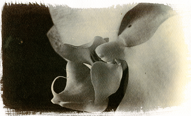

I found Chrysotypes and that some folks who work in that process use a 40% solution of AFO. I decided to try that and gained greater DMAX of the print. An example is provided below. Satisfied that I now had a fairly consistent method on paper I started to shift my focus back to prints on glass. I did not have gelatin on hand so I decided to borrow from the albumen print and make albumen using AFO instead of the traditional chlorides. A day later, filtered off the scuzz and floated a piece of paper onto the albumen and exposed it to light.

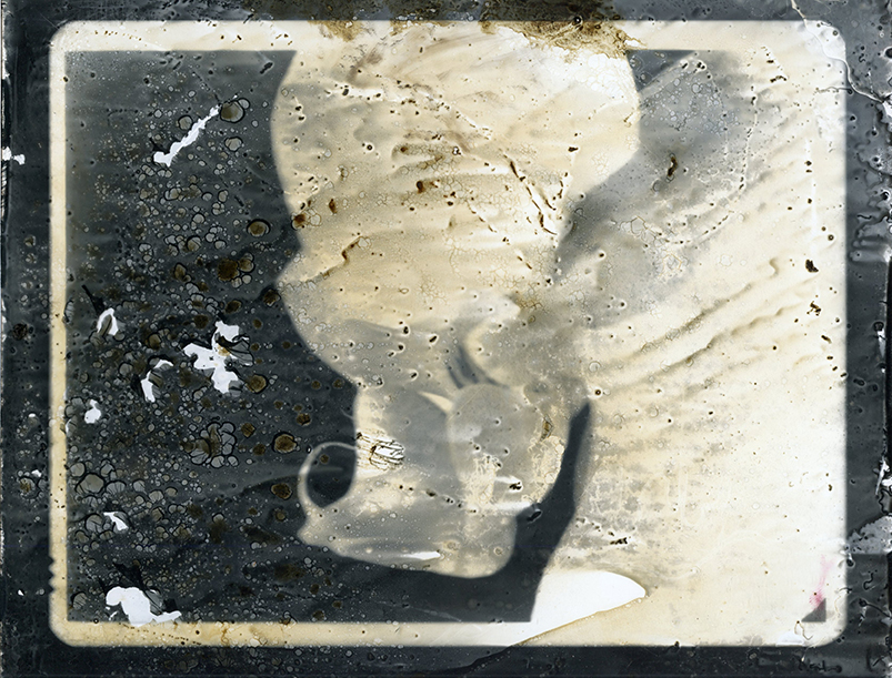

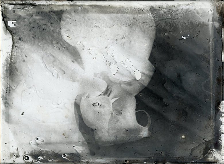

I developed the exposed plate in a bath of 10% Silver Nitrate and got the results that are posted below. I found that double coating albumen helped adhesion. My problem at this point is the initial flowing of the albumen to create an even coat. If there is anyone who has any thoughts, suggestions, or ideas please feel free to add them. I have a day off and will be coating a few more plates of glass through out the day.
