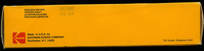

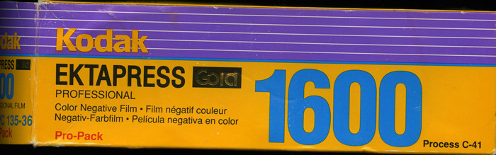

I picked up a bunch that had been stored in a basement for the last 18 yrs and it turned out very nice. If you look in my gallery (I cant seem to get the link directly to it), you will see a couple of examples of scanned negs from the first roll I used. I was very pleased. Look towards the bottom--a little girl blowing bubbles. That was home processed with a blix kit in a Jobo.

All I can tell you is I have several propacks that say expire 08/1990 (I was off a year--that makes it 19yrs old). I can also tell you that in my case I rated the film at box speed and the results of which can be viewed in my gallery as described. Your mileage may vary--this was my experience. The negs were level and auto color adjusted when scanned. Give it a whirl--I for one am going to continue shooting the film I have that can't possibly exist :wink:
