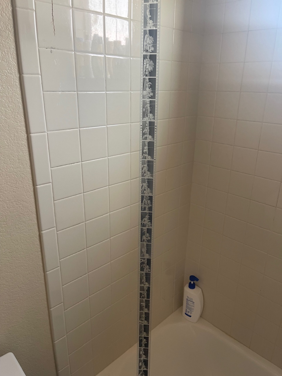

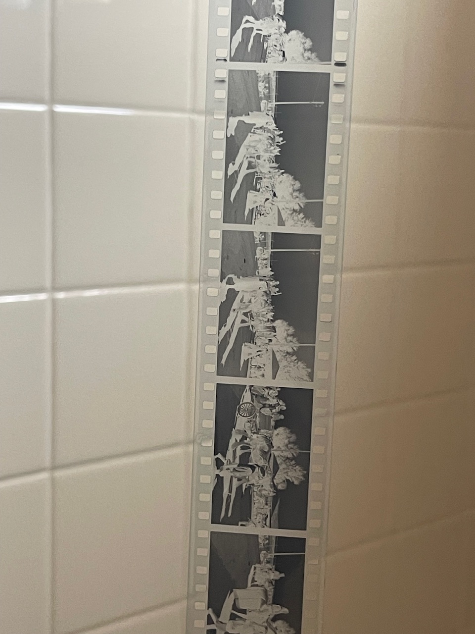

Foto 200 roll is processed, and I have to say, this film is so incredibly thin. 0.06mm is no joke, it was hard to load onto steel reels. But, the images look good so far, although they’re just a tad thin I think. Maybe some extra time in the soup wouldn’t hurt. Unfortunately it doesn’t look like I used an IR filter on any of these, I thought I had but I guess not.
