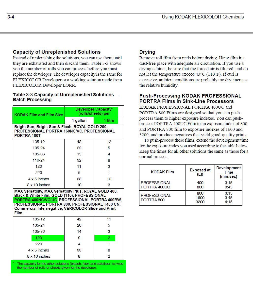

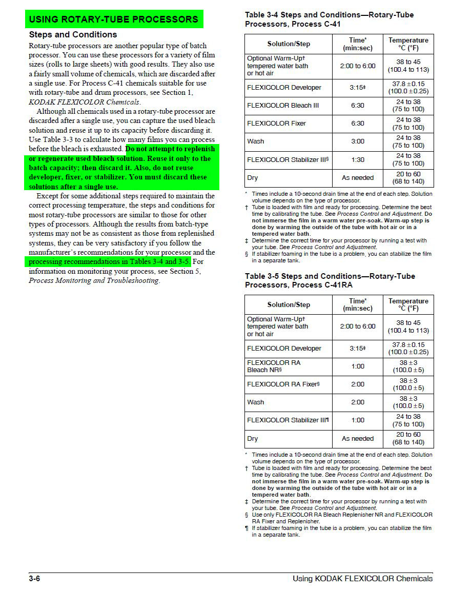

Reading the C-41 Z-manual about rotary tube processing and the capacity of "unreplenished solutions" Kodak states that you need 1 litre of developer to process 2 rolls of Portra 400 120. And the developer should not be used again.
Kodak's recommendation is obviously the best way to go but.... it does seem like a lot of developer for 2 rolls of 120. It also means that I'm limited to developing 2 rolls of 120 at a time. What's the consensus with Jobo's tank capacity (in a CPP2 Processor) vs Kodak's recommendation?

I’ve just reread my copy of Kodak Z-121A C41 manual, which as far as I understand it is the original C41 manual; dated 1975. Whatever, it was the first one available that I know of in Australia.
No mention is made of actual capacities like the current electronic manual you refer to, so essentially one would have to guestimate.

Using a 1520 tank with a 1530 module bolted on, one can run up to 4 x 120 films and a single 35mm film, or in my case a 35mm control strip. I remember trying various combinations with a control strip inserted and eventually came up with various strategies. This is using 600ml of solution, not 1 litre.
For 135 the maximum that could be done and keeping the control strip within the parameters, was 8 rolls of 135 x 36 frames per 1 litre.
With 120 film between 3 rolls and 4 rolls were usually within the parameters; although if my memory is correct, it was just within the parameters with 4 rolls.
Eventually I settled on using a 1540 tank, 1510 + 1530 module, minimum solution is 470ml, I always used 500ml of solution. With this and using C41 120 film, I developed 2 x 120 rolls per 500ml of go juice. Did that on and off for about 20 years, worked a treat. That of course doesn’t mean it was on the money from a technical point of view, but it was pretty good and the colour prints I obtained were at times devastatingly good.
You need to understand that Kodak invented the process, they were the best ever technical company to deal with and if they suggest that so many rolls of film per litre is the go; then you can bet that suggestion is correct for perfect developing.
One can always deviate and still get wonderful development, day in day out, many do and I did. Just remember to carefully observe your results with what you develop and choose which parameters are acceptable to you.

Kodak says use everything 1 shot with Jobo. I have replenished bleach and developer with no problems. The developer is so cheap I use 1 shot. I use stop bath as well . And for bleach and fixer Flexicolor RA C41
