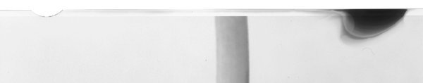

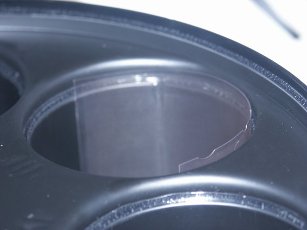

I scanned the affcted negative. Here is my problem. Also here is how I do load the film. I must admit, however, I did not pay too much attention to how deep in push the film into the tube. Sometimes the film edge was not exactly parallel to the edge of the tube. I posted the same question to largeformatphotograpy.net forum and got the advice that this may be crucial, which I did not realize. So sometimes my film was certainly loaded not exactly as shown.

well, looking at your negative example, the perfectly clear edge with the even line looks like it is supposed to look. If you are getting that inconsistently, I'd check your method for loading your sheet film holders for consistency. The wierd blob on the negative looks like some kind of developer drip. That could be caused by either the filling method (since it is an Expert drum being used off a Jobo processor, you'll have that issue with filling while the drum is not rotating) or you aren't cleaning your drum carefully enough between batches, and the film is sticking to the wall of the drum and trapping chemistry between it and the drum wall, causing the overdevelopment spot. You need to double-check to make sure you are loading the film in the drum emulsion side IN, not out.

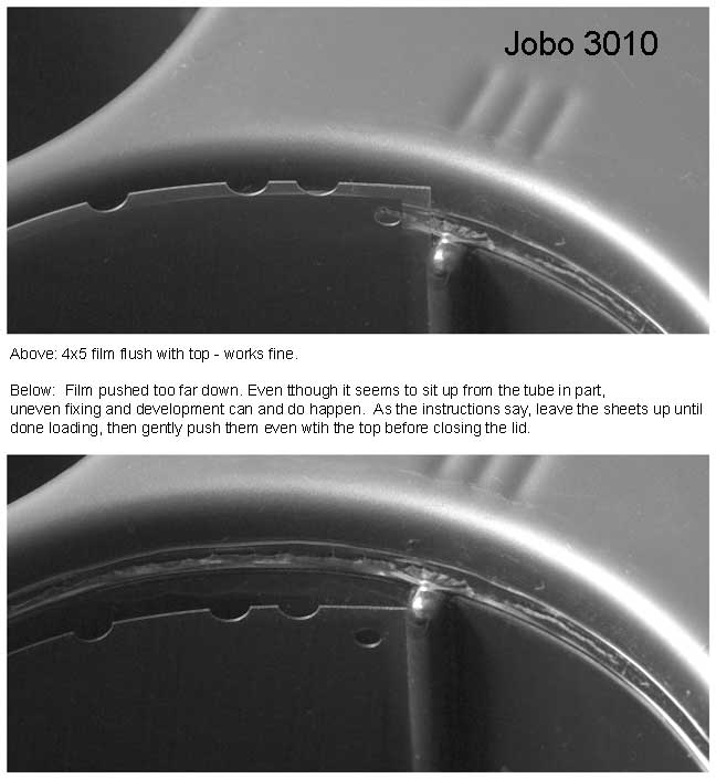

Definitely what has been said makes sense ( especially facing the emulsion the correct way ). Here's a snapshot regarding loading the film - pushing the film too far in can cause negatives not to clear properly. While the photo here shows a 3010, it could be the same issue for the 3006.

Also, I would appreciate a scan of the entire peice of film, I can't even tell what the problem is from the picture you uploaded.

Looking at the negative example, it looks to me like perhaps the tube wasn't properly dried prior to putting in the film.
