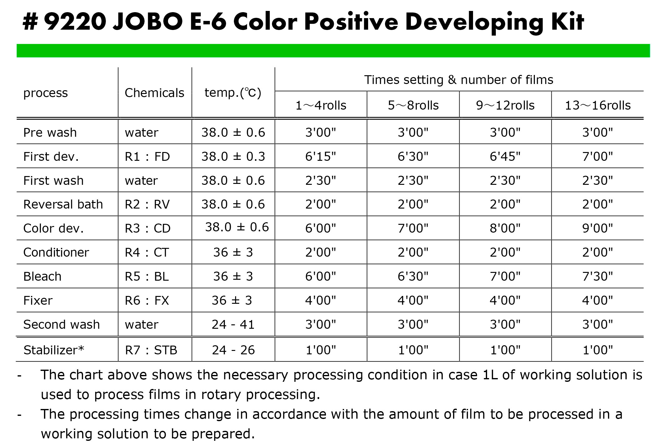

This could get a little hairy, but here's how I'd approach your problem...
In the chart below, Jobo states that up to 4 rolls of 135-36 can be developed in 1 liter of working solution without the need for extending times in the FD, CD, and bleach. You reported that your tank requires 1.6 liters of working solution to adequately cover the film. That volume works out to a maximum developing capacity of 6.4 rolls of 135-36 without needing time extension (i.e., 4 rolls/liter * 1.6 liters = 6.4 rolls).
Now, if you recall from post #2, we determined that a single 30.5-meter roll of 16mm film has the equivalent surface area of 9.5 rolls of 135-36. If we divide 9.5 rolls by 6.4 rolls, that gives us a dimensionless factor of 1.48. I'm going to call that the "column factor". The column factor tells us which of the four columns (1, 2, 3, or 4) a specific developing scenario corresponds with. Column 1 corresponds with the 1-4 rolls case, Column 2 corresponds to the 5-8 rolls case, etc. A column factor of 1.48 is bigger than 1 but smaller than 2, so that places us in the second column. Ergo, developing a single roll of 30.5-meter 16mm film in 1.6 liters of fresh solution will, in theory, require the times listed for 5-8 rolls.
In general, the formula for calculating a column factor for 30.5m x 16mm film is given by:
Where:
C = column factor
2.375 = unit conversion factor (basically, this arises from 9.5 rolls ÷ 4 rolls/liter)
Nr = roll number (ie., 1 for the first roll developed in that batch of working solution, 2 for the second roll, etc.)
V = volume of working solution, in liters.
So for example, if you then attempted to reuse that same 1.6 liters of working solution to develop a second roll of 16mm film, you would calculate a column factor of 2.97 (i.e., 2.375 * 2 ÷ 1.6 = 2.97), which puts you just barely inside the third column, such that you would need to use the times listed for 9-12 rolls. Of course, that's cutting it a little close, because a column factor of 2.97 is very nearly big enough to move you into the fourth column, in which case you might opt to use the times listed for 13-16 rolls, instead.
Personally, I think the easiest approach would be to mix the entire 2.5 liters up at the same time (provided you have storage containers large enough to do so). The reason for this is because we've calculated that the entire 2.5-liter kit has the capacity to develop 4.2 rolls of 16mm film (at least, that's according to Jobo's capacity guidelines). That number -- 4.2 -- corresponds almost perfectly to the four columns provided in the directions. So, by pouring the used solutions back into their respective bottles after each development session, each successive roll will simply correspond to the corresponding column in the instructions -- i.e., roll 1 uses the development times in the first column, roll 2 uses the times in the second column, etc., etc.
(And just for fun, you can prove this to yourself by using the equation above to calculate the various column factors for a volume of 2.5 liters.)
