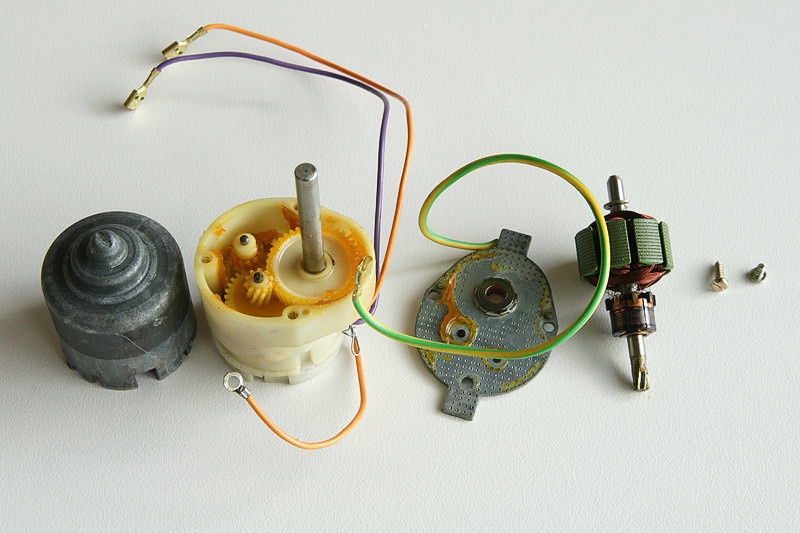

Below is the exploded view. As you can see, there is plenty of grease in the gearbox

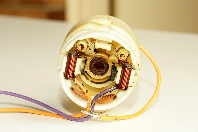

Looking at the bell end, you can see quite a bit of black around the brushes, suggesting a lot of arcing

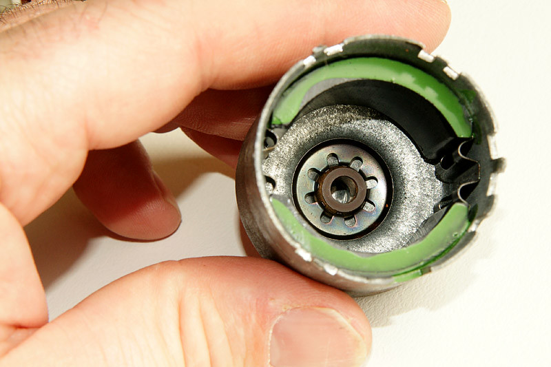

The can and magnets all look fine, but the can end of the shaft and the bush did seem quite dry

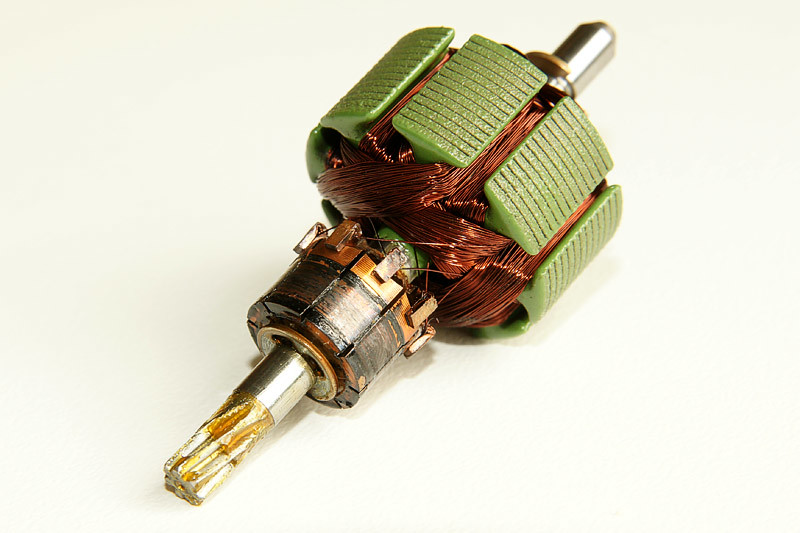

The armature shows a lot of carbon buildup, again suggesting bad contact
Jobo CPE-2 Motor, Armature by hoffy37
And finally, the culprit. My suspicions is that this brush caused the motor to fail finally.
Jobo CPE-2 Motor, Burnt Brush by hoffy37
It looks like the plastic has melted, which has deformed the slot. The brush had been rocking backwards and forwards and would not move freely in the slot. I am surmising that this has caused bad contact, arcing and heat buildup and finally failure.
I tried to clean the arm and the brushes as good as I could and re-assembled the motor. It seemed to spin fine in one direction, but was really sluggish in the opposite. To me, this suggests that the rocking brush is probably the cause for this bad performance. I had thought about working out a way to sleeve the brush slot, but haven't come up with a good solution yet.
