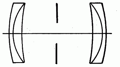

. . . Does anyone know what the glass configuration should be for this lens? . . .
Rapid Rectilinear

That is the configuration of the Queen cells. Thanks Jim.
