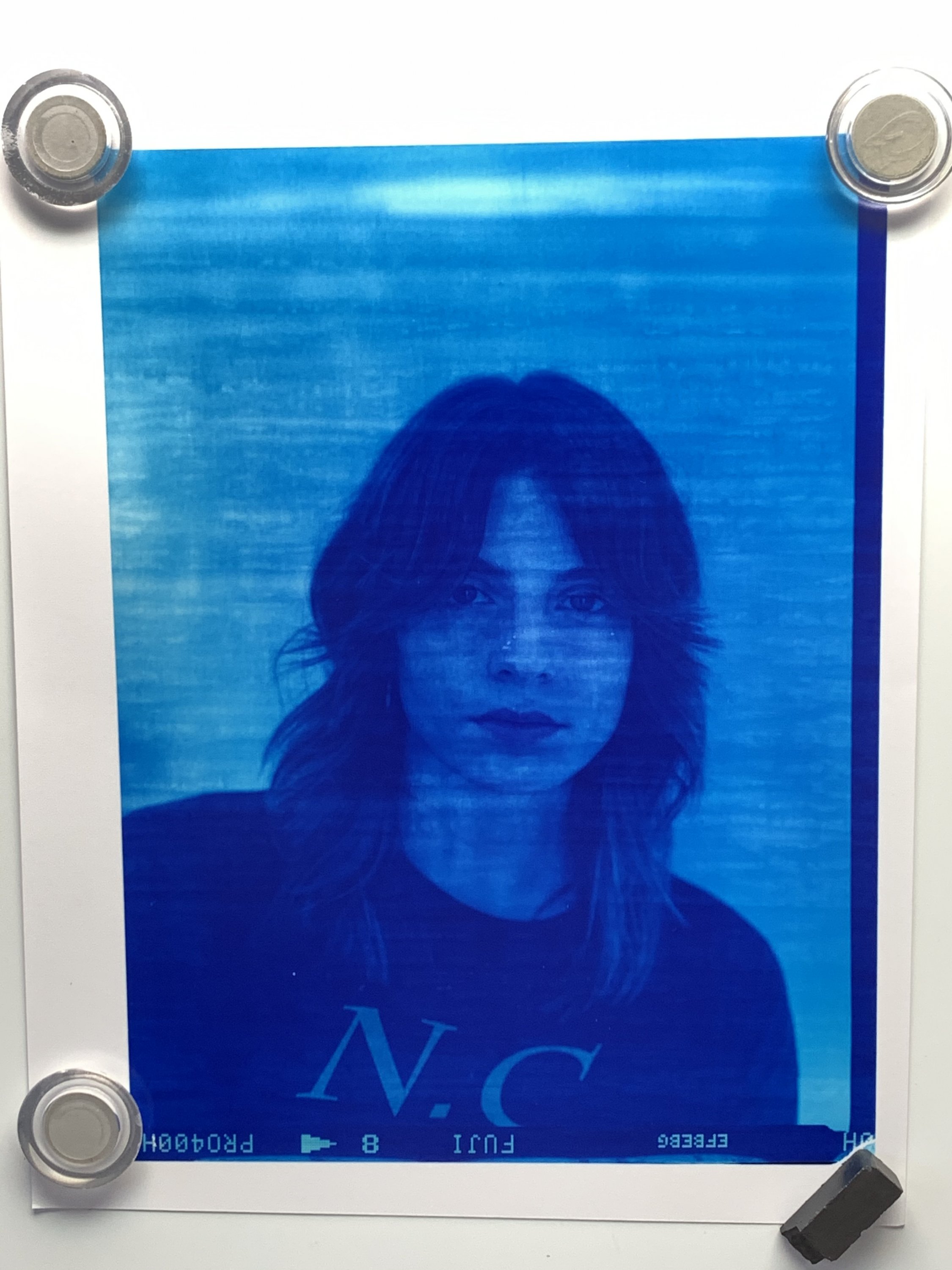

The Colex roller transport processor at the darkroom has started to give me issues - specifically roller marks and banding. I’ve noticed the issue almost exclusively on my Kodak papers (Endura, Royal). My Fuji paper (CA type II) is largely unaffected. I know the processor is set up with Fuji Digital RA pro chemicals (P1-R developer). I’ve attached a photo of an un-corrected test print to show it at its worst. What the hell is going on? I will add the first response was to take out and thoroughly wash the rollers. They’ve been washed at least a couple of time within the past week in attempts to rectify the issue, but no dice.
