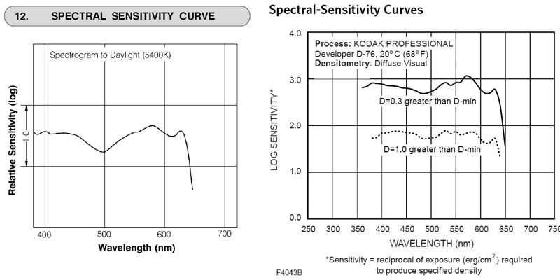

Attached is the spectral response of Tmax 400 and Acros. Pretty similar in my opinion.
Both are taken from Fuji's and Kodak's spec sheets. The one on the left is Acros.
Yep. It won't really look like Acros however. Acros IIRC is not a fully panchromatic film, so it favors blues over reds. It may be that you can use a filter and pull the look closer to Acros, but if you do that you end up loosing some of the shutter speed you wanted from a 400 speed film in the first place. So IDK.
