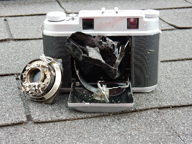

The bellows were something to pay attention to concerning light leaks , but I had leaks into the film chamber that I'll have to
look back through old remarks I had made . I really loved the quality of the pics , but holy crap after a while I finally took a
hammer to it .

Well, that's one way to be sure you don't "forget" and load the camera you swore you'd never use again...
hammer to it .
LOL this reminds me of someone I knew, who finally threw his Kiev 88 into a lake.
