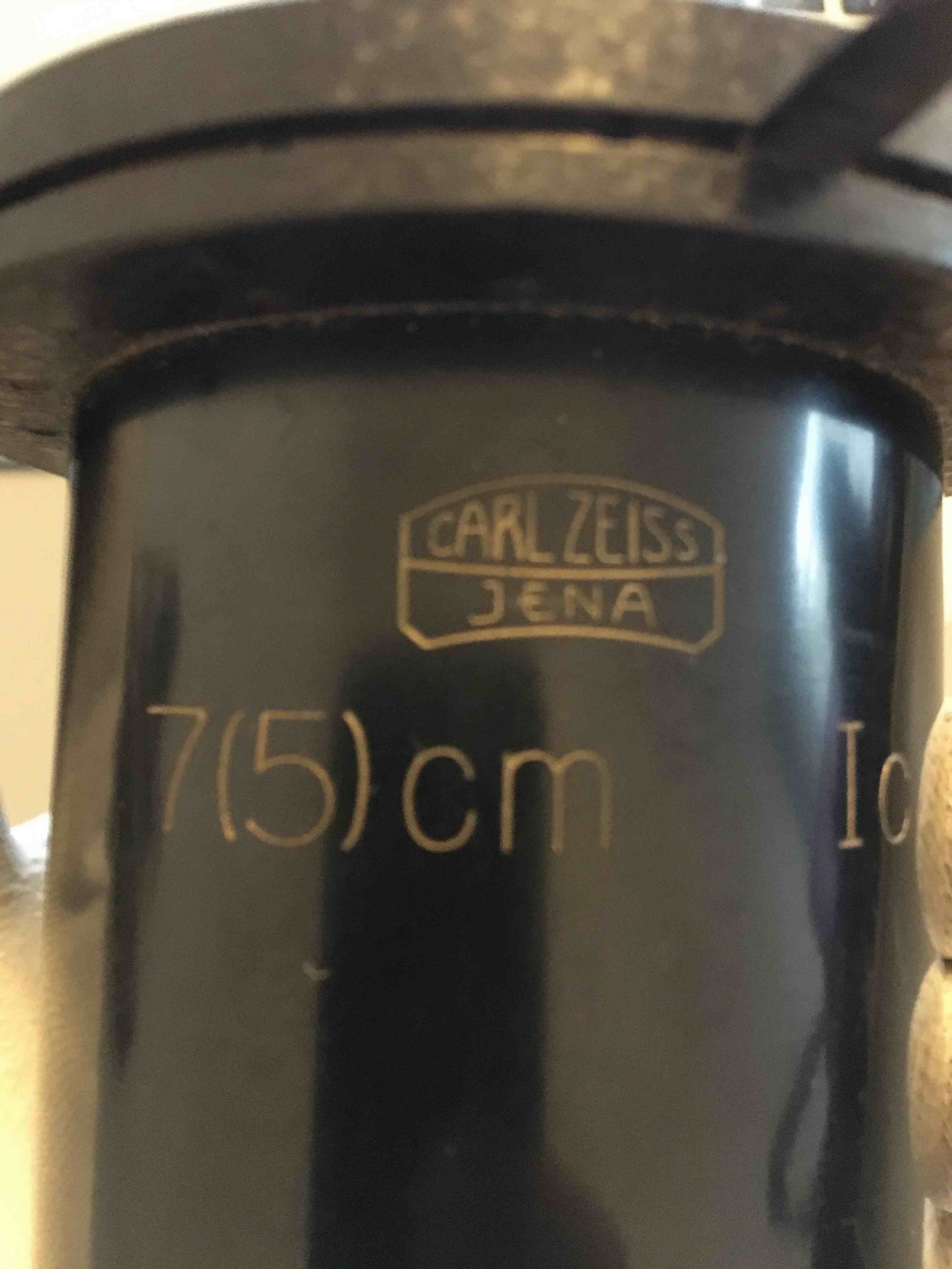

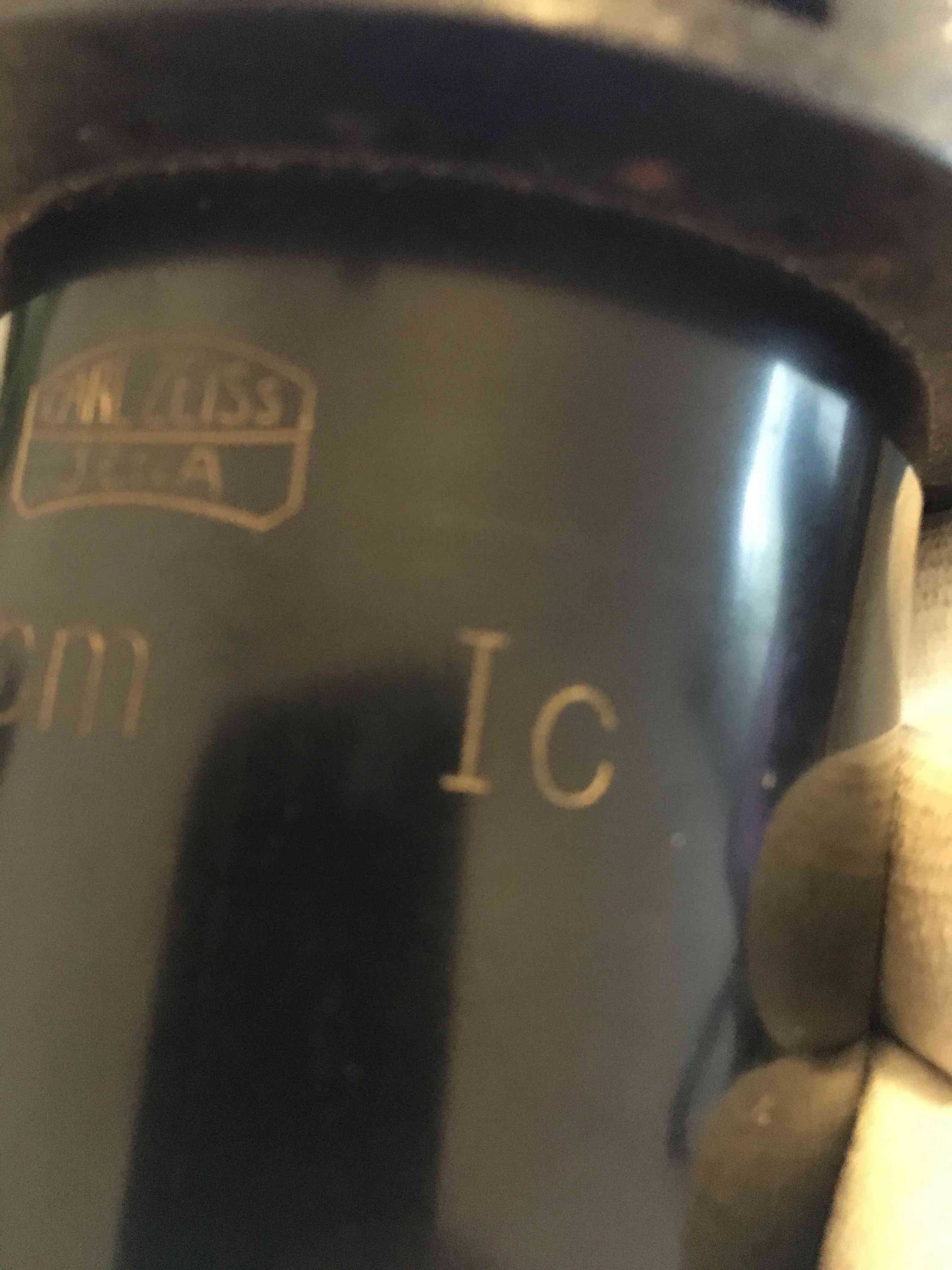

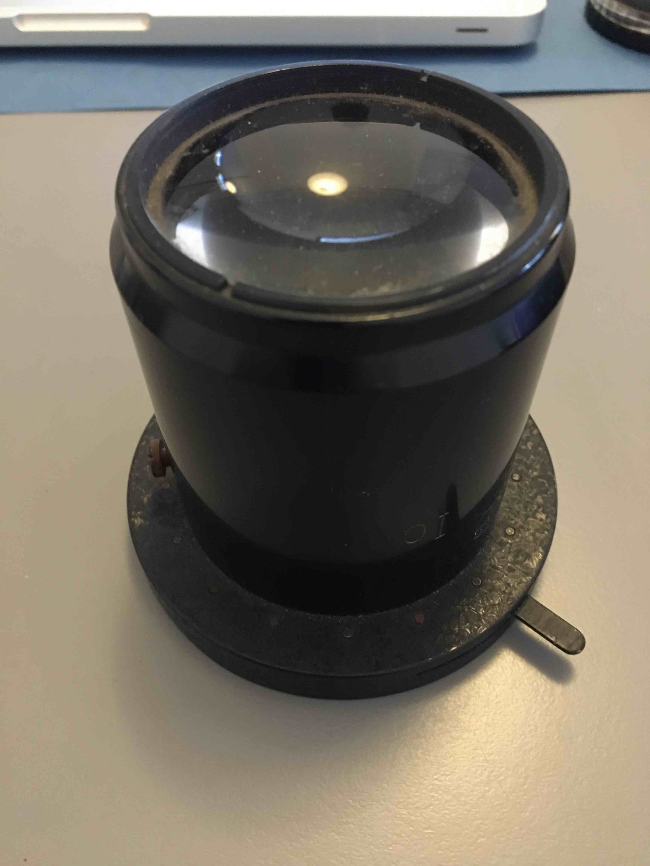

I got a box with some old photography equipment and I can't find the same lens when I do the google
specs: Carl Zeiss Jena 7(5) cm Ic
18 blades
Is this an enlarger lens or for a projector perhaps? And any idea on the value?

One might ask oneself:
-) why does it lack an aperture scale ( was there a additional further mechanism?)
-) why is the aperture at its end (is there a further group missing?)
-) how was it mounted?
-) what is its basic design (number of groups)
etc.
Zeiss was a major optical firm, busy at all fields of optics, thus it could be from any field...

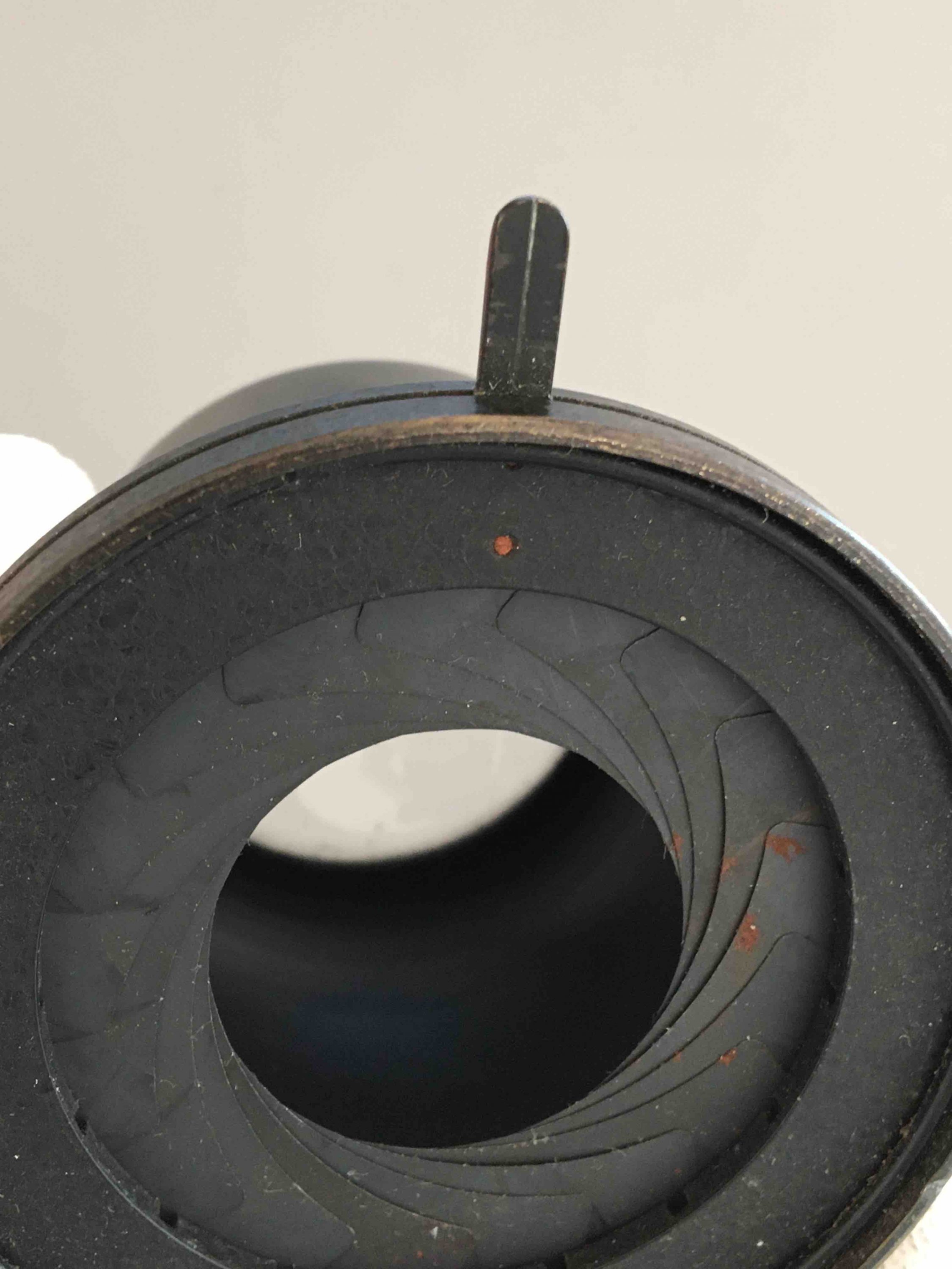

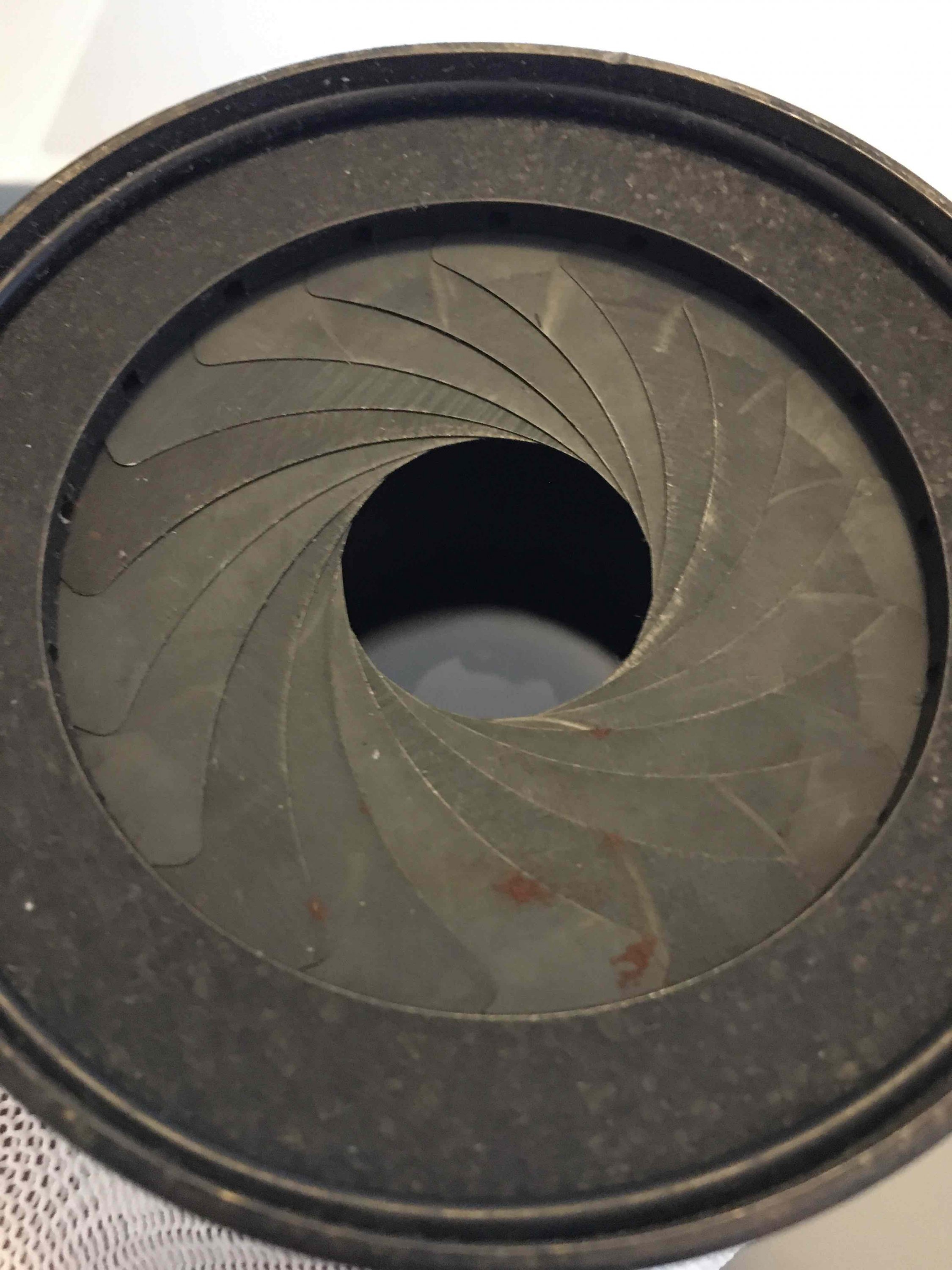

It really reminds me of a lens enlarger because of the base. But, indeed there are not any aperture marks. And because of the lack of aperture marks and it's quite heavy (maybe bakelite ). The lever works smoothly:
opening and closing

It looks very much like a lens from a microscope condenser (this fitted below the "stage" of a microscope, where the subject slide was held), and concentrated and adjusted the light. I have simliar condensers on my own kit, and, as AgX says, Carl Zeiss Jena produced many optical equipments from way back into the late 1800, particularly microscopes.

Yes it looks a lot like a microscope condenser lens for light microscopes. We still use them in school laboratories, though only one is Zeiss and I don't currently have access to my work. The lever and the presence of so many blades and no f-numbers strongly suggest this function for the lens.

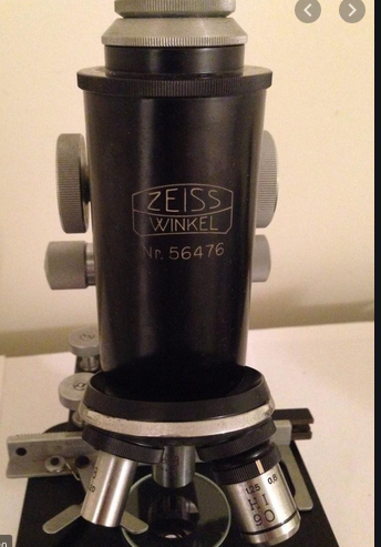

@Agulliver thank you for answer......I have narrowed my search but a simple google image search didn't do the trick. I haven't found the exact condenser...I am going to search different fora/forums......
is the closest so far

The part of that microscope which you are showing in your picture is actually the main "body" part of the instrument, The "condenser" would be under the "stage" where the microscope slide (holding whatever you're looking at) sits. The light comes in at the bottom of the scope and through the optical system, then out through the eyepiece at the top. There's quite a good diagram on http://www.biologydiscussion.com/mi...roscope-structure-and-working-principles/5822 (see Figure 1.4),
I think that your picture shows a microscope from 1956 (from the serial number) when the Winkel company had become part of the West German Zeiss group. Your "Carl Zeiss Jena" item would be from the original Zeiss company in Jena, East Germany,either pre-war or post-war when that part became a GDR state company "VEB Carl Zeiss Jena".
Wow, valuable information......now I can narrow my search period wise......
