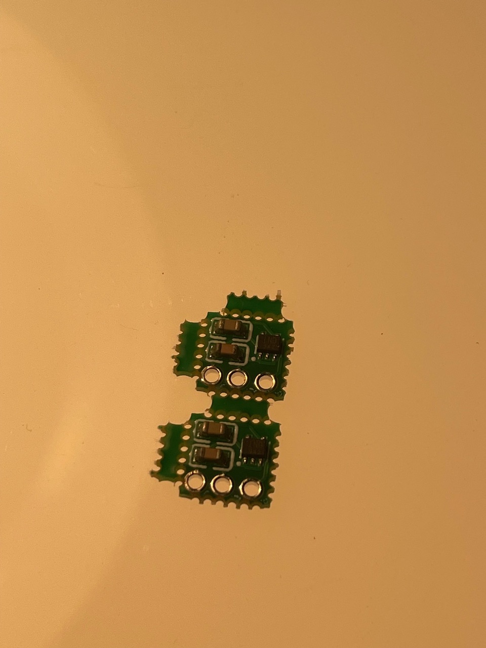

I would add “voltage regulator circuit” to your wish list. Filip Dee got these made up. They provide a rock solid 1.35 volts with a bit of necessary hooking up.

@Bill Burk I saw those actually. Does he sell them anywhere, or is this a "go order a minimum order quantity for yourself from a PCB place" situation?
Small enough to fit in some kind of 3D printed battery adapter with an SR44, or will I be doing some soldering?
And if I need to solder it into the meter circuit, how many connection points? The diodes I have en route have 2... haha.

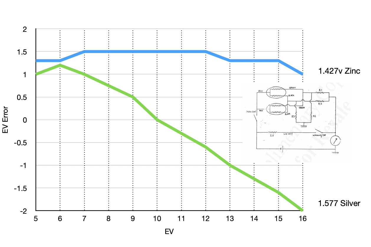

The voltage regulator (above) requires a camera with a negative ground. Maybe someone can re-configure one for a positive ground camera like the OM-1. Of course one could try to place the regulator between the battery and the cap or incorporate it into the cap somehow.
My OM-1 works well for me with a zinc cell and exposure index change.

About 3 decades ago, I did a test with my Olympus OM-1n, using both mercury oxide cell and alkaline cell. Comparing the metered result at different light levels, I discovered that a single offset to correct for voltage difference could NOT be used, because the degree of error using the alkaline cell (at a given Voltage level) was different in bright light than in dim light!
That is when I decided to get a genuine MR-9 that would convert the silver oxide Voltage to a fixed Voltage which mimiced the mercury oxide cell behavior. At the time, there was not yet offered modification of the OM-1 itself so it internally corrected for varying Voltage which was exceeding 1.35V.
Today, there are so-called 'MR-9' adapters which do NOT do any Voltage conversion, but which merely physically permit the use of smaller air cells, which are cheaper to buy but which deplete their life once the air seal is removed.

Reach out, I don’t know, I think I gave him $100 and he gave me a bunch.
It takes some ingenuity to get it in circuit because you need to have it behind a switch. Three soldering points.
