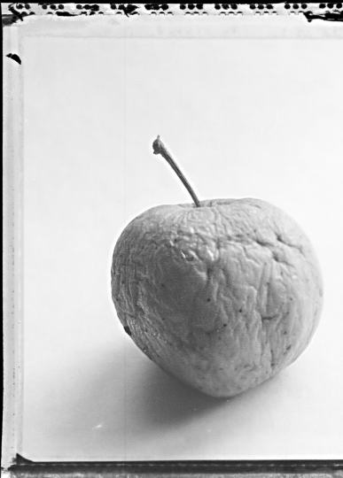

What's that about close-ups "not practical"? Here's one - contact print from polaroid negative:

Not close enough :smile:
