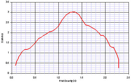

Yeah -- the current Oriental is a 2-emulsion paper masquerading as fixed grade. It is made of two high contrast emulsions with slightly different sensitivities. Changing the filtration doesn't change the contrast, though. I think one of the east-bloc papers was also a 2 emulsion 'fixed VC' paper, but I can't remember which one it was.
I didn't know that Ilford was using color-sensitized emulsions, in different proportions for each grade, for its graded paper. That's really insipid.
Finding crypto-VC papers is rather easy (well, easy for some). If you take the derivative of the HD curve and end up with
then you have one. The 'teat' in the middle is where the two emulsions overlap. It is also possible to get a dip in the middle.

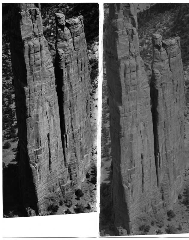

Controlling Contrast of Graded Papers with Multigrade Filtration
Following from my previous postings, I attach a scan of two test strips. The scan is levels-corrected to look as close to the original as I could make it (so both are a bit overexposed). Both strips were scanned at the same time with the same settings. They are both on the same sheet of Ilford Galerie grade 3, exposed for the same time, processed identically in Dektol 1+2 at about 2.5m, then stopped and fixed normally. The one on the left was exposed using the blue (hard) filtration and the one on the right got green (soft) filtration, using my Ilford 500H dichroic head. Each filtration does include a small amount of the other one, perhaps 3% by time, due to the way my timer works.
The difference in contrast is so explicit that as long as my results are repeatable it could be a useful way to further control contrast of a print, perhaps easier than some other techniques typically used with graded papers.
Please note that my paper is a bit outdated and I will redo the tests with a fresh batch, just in case this result somehow relates to a component of the emulsion ageing in a peculiar way.
Rafal

I attach a scan of two test strips ... it could be a useful way to further control contrast of a print, perhaps easier than some other techniques typically used with graded papers
Wow.
I wouldn't know I would say it is a graded paper technique - the paper is obviously VC multigrade paper. So much so that I wonder if it was somehow swapped at birth.
I have never seen a graded paper do that, but then I have never tried. Something to do next printing session while the prints are washing.

Wow. ... the paper is obviously VC multigrade paper. So much so that I wonder if it was somehow swapped at birth.
This was a freshly opened pack of outdated paper, definitely says Ilford Galerie, grade 3, on the box. But there is always a chance it may be a faulty batch. In fact, I would be happier in a way that way. :smile: I will retest when the new pack arrives in a few days. In the meantime, please bear with me, as there is always a chance this was a dud batch. Still, if it were a "swapped batch" with MGIV I would expect the tonality of the strip on the right to be squeezed towards blocked values, rather than being in heavy midtones, perhaps.
