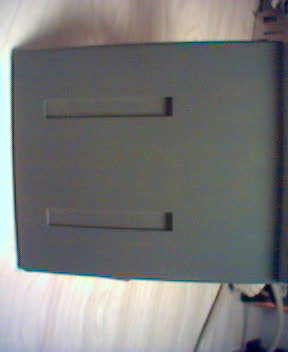

First, the lamp house top cover :
It is made from a 1mm thick steel plate painted machinery grey (Durst standard color) outside and flat black inside. The edge in contact with the lamphouse are felted to reduce light leaks. In the center of the cover there are 2 rectangular holes, closed from the inside with a spot welded metal plate having two ply to make a very small space between this plate and the lamphouse cover itself. I think this is to serve as a cooling air entry and reduce light leaks.
Dimensions are (all in centimeters, there are 2.54 cm in an inch)
largest (from rear to front) 14.7 cm wide 12.7 cm. the borders are made of one ply of this steel and measure 1 cm. There are two "bumps" one on the left and one on the right side to help the cover rest in place.
I hope the picts (from a really bad camphone) are useable

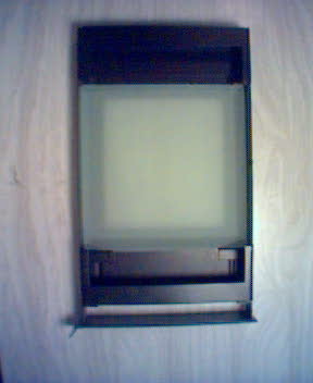

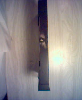

The Taufil is another story.
You have the picts on the previous post and this one.
The taufil is made like a drawer with an handle made from a sheet of steel spaced from the Taufil's body by two pieces of steel measuring 15 mm each.
The overall dimensions of the drawer part are 199 mm long and 123 mm high.
This drawer has two important features :
The main one is a rectangular hole facing the hole in front of the lamphouse measuring 88 mm height and 95 mm wide.
And the one you will have difficulties with is a spring loaded device to maintain the filters or heat absorbing glass in place. these are the left parts seen in the picts (this part moves and travel about 10 mm) the right parts are fixed.
On my picts there are a deeply thick frosted glass used to even the light output on the baseboard. I've removed the glass in the last picts.
For the lamp, I use either a Philips double enveloppe halogen bulb sold in Europe une the name HALOGENA which is a 95 mm diameter bulb white frosted and quite perfect in shape and color, without markings which is 150 W in power, has an E27 base which is Durst standard bulb socket. As it is an halogen, output power is quite high. Using the frosted glass output is really even provided the lamp is centered in the lamphouse. The other lamp I use is a 150 W enlarger bulb wich is, unfortunatelly, only 65 mm diameter but produce quite a good light with the frosted glass on the filter drauwer. I do not use, even if I own multigrade filters on oversize able to fit the TAUFIL. I use a Kodak under the lens filter holder screwed onto the red filter support and under the lens Ilford filter for contrast control on the paper.
Hope this helps and feel free to ask questions if needs arise.
