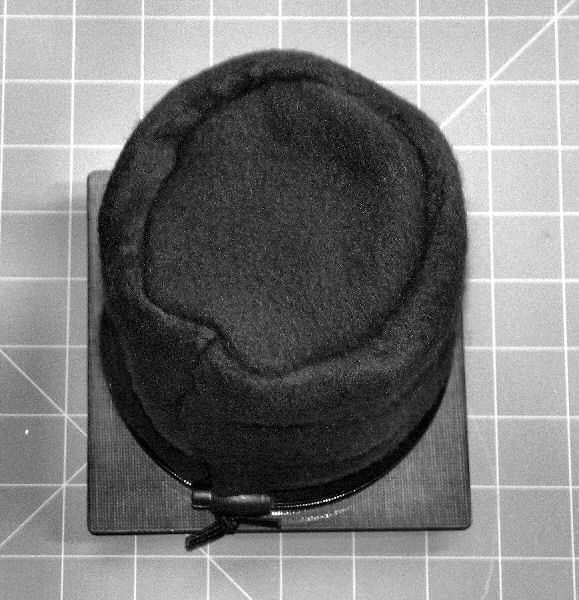

455 mm f9 Apo-Nikkor Process Lens, Barrel Mount
The lens diameter is about 5 inches. The Wehman lens board is 5.25 x 5.25 inches. The lens sock is double thick Polarfleece.

Lens Sock/Shutter in place on 455mm Apo-Nikkor
Pictures taken with this combination are very sharp - no camera movement.
