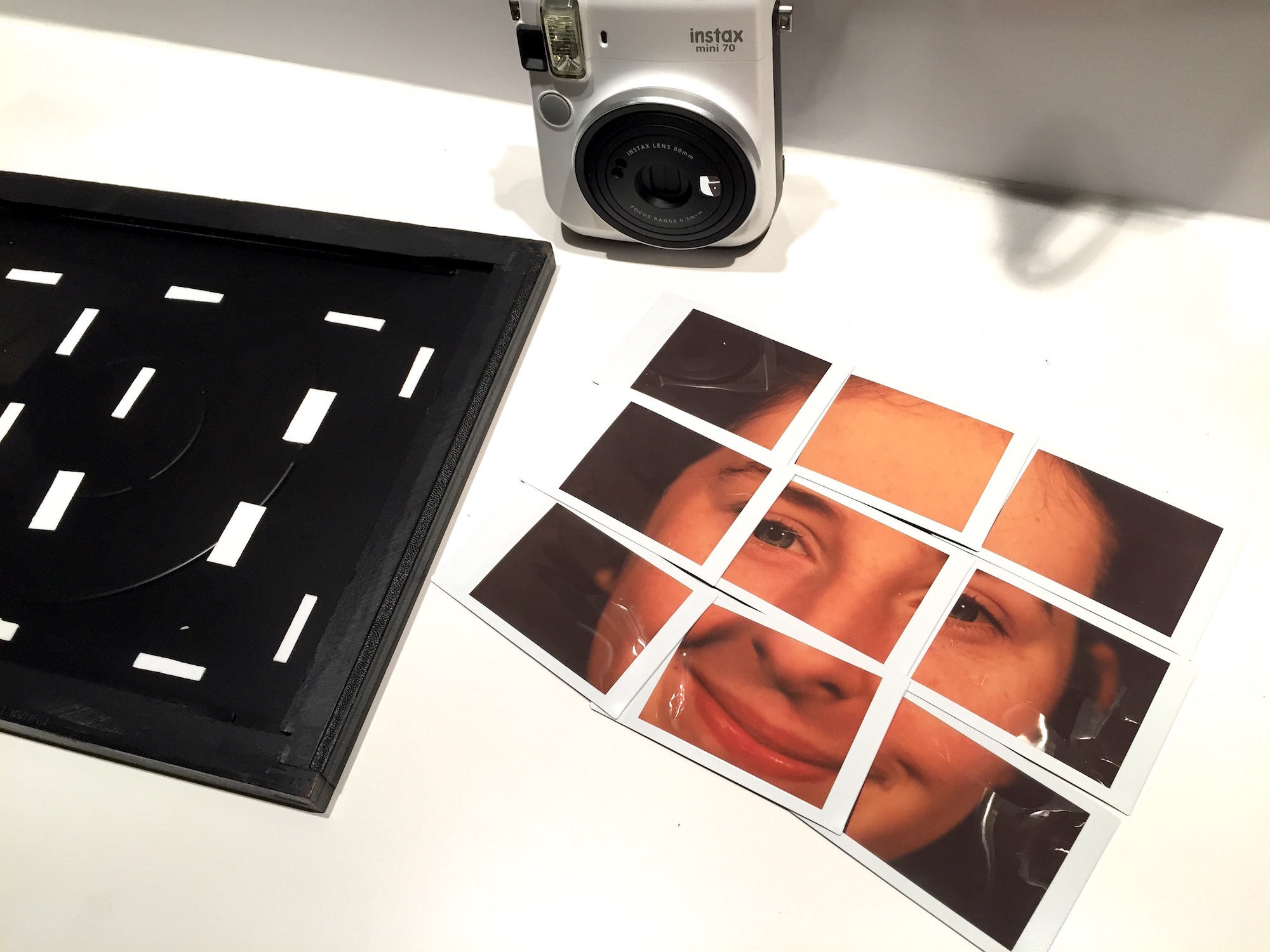

    Sometimes these turn into stepping-stone project. Originally a cheaper alternative, but when you look at it, this cost $7.50. Impossible is $17, but you get a complete image. The price difference is not that great.
    If I did buy some Impossible 8x10, what would I need to expose and process it? Special film holders? Special processing apparatus?
    BTW, this was stupid-easy to do. The Instax film slides out of the holder with your thumb. Use 2 sided tape to attach them to a film holder. The tenth one can go on the other side as a test shot. When done, peel the little light trap off the empty Instax cartridge and then the film slides very easily back in the slot.
    After re-filling the cartridge, place it in the Instax camera and press the button, keeping the lens covered.

    Your talking about taping to a 8x10 film holder, correct?
    :cool:

    Yes, see the film holder in the picture. Cutting and placing the little two-sided tape pieces was the most time consuming portion of the whole project. Looks simple, but I had to space the tape so that I could feel the top and left edges of the 'index' tapes to line up the Instax films by feel. Then I needed overlap to slide the developing pod under the next film.
    The opposite side of the film holder has just two little tapes to hold a single frame in the middle; the tenth film from the package which is the test image.
    For that image I used my 300mm Fuji at f8 (wanted f5.6, but the lights were too strong; with ISO 800, my Copal 3 only goes to 1/125!)
    The camera bed was extended all the way in front and the rear was pulled out another 150 mm. Probably about 600mm extension for just about 1:1 reproduction.
