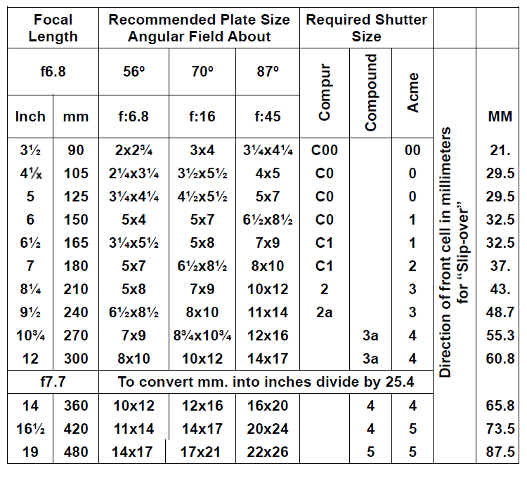

I should have added the chart I posted earlier in this thread is the Goerz Am, Opt. data for the Dagor's coverage. They clam 14"x11" at f45, but as that's not an optima f-stop 12"x10" is more realistic.
Ian

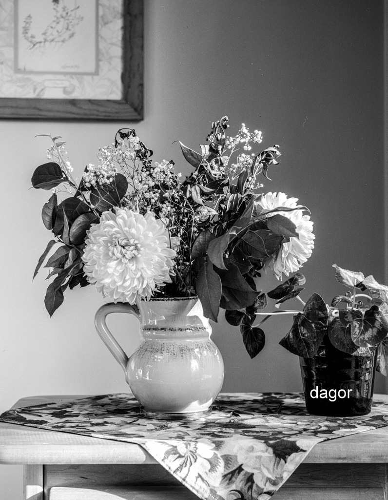

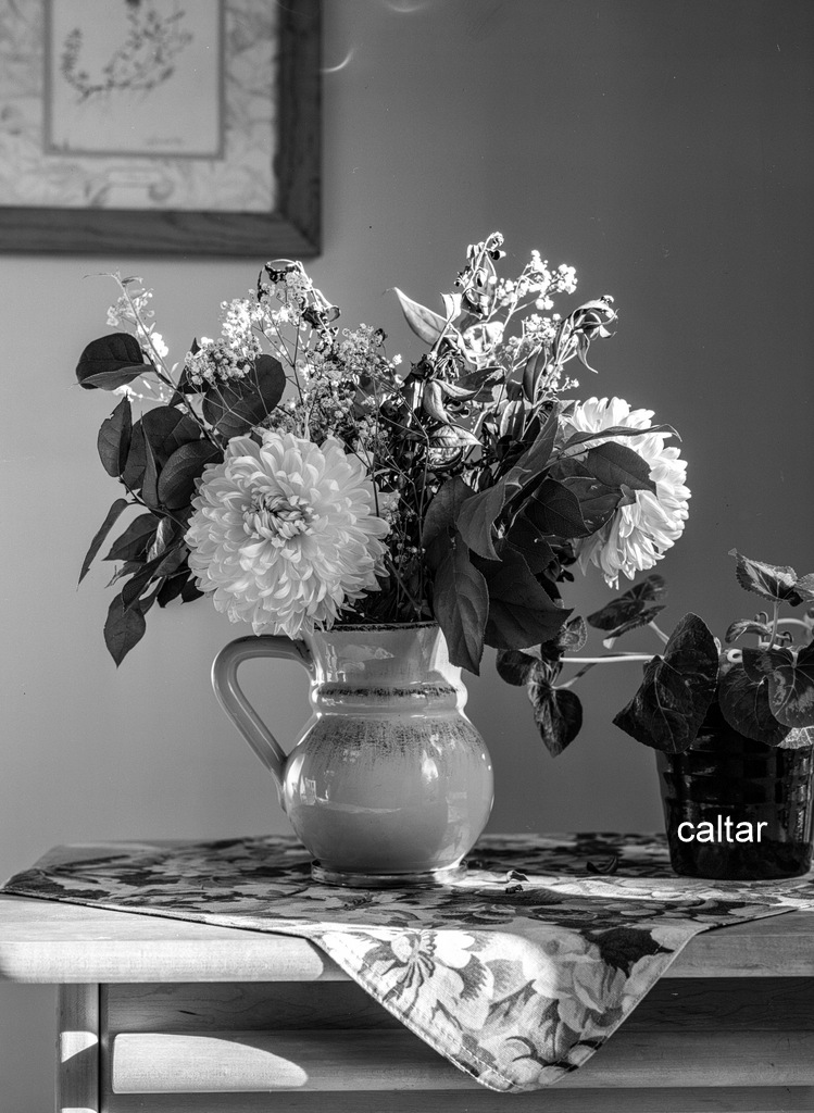

Here are a couple of quick shots with the lenses. Cropped with little processing.
