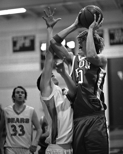

I would give Tri-X in Diafine a try. Here is an example:
Canon EOS-1 - 85mm F1.2L
Tri-X (TXT) @ 1600 in Diafine
Prints nice with a number 4 filter
1/250 @ F2.8 - Available Lighting Only

Thanks very much, Eric! I'll run a roll of Tri-X through Diafine in the next 24 hours and determine what I get and how much I like it.

That's a nice shot-Eric. The expressions in the shooter and blocker make the shot interesting.
My neighbor shot for his high school newspaper. He liked the 4x5 speed graphic because of the high shutter speed. This would have been in the 50's. I can only imagine the monster flashes going off to give him enough light with the older, slower films.

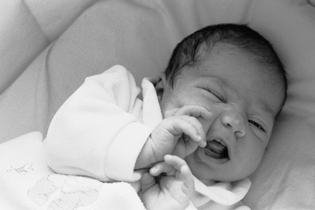

I have had a good success with Tri-X @1600 developed in Microphen (hard to find I'am afraid, but you'll never know...). 12 minutes with 30 sec initial agitation and 1 inversion every 2 minutes.
Here's an example from the shots I took a a few weeks ago of my newborn daughter. Less grainier than similar shots I did with Delta 3200, although a bit more contrasty.
Good luck :smile:
